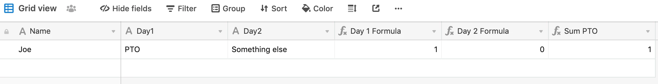

Hi @Melisa_Goh - how about this? You have 7 fields (or maybe 5), one for each day of the week. Have another 7 (or 5) with this formula:
IF(Day1 = 'PTO', 1, 0)
(modify Day1 appropriately for each day of your week)
Then have another formula field that sums up the new formula fields you have created.
{Day 1 Formula} + {Day 2 Formula}
Here’s a 2 day example:
Then hide all of the Day 1 Formula fields to tidy up the view.
JB
JB
