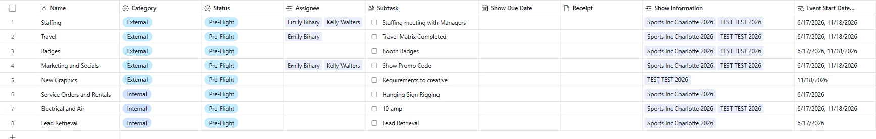

Emily.Ann
I got this idea from the AirTable webinar for their Field Marketing team, where they can click a button and generate standard tasks for different events.
I worked with an AirTable team member onsite at the NYC event and created my “Tasks” table and I know how to make the button automation. But I seem to still be missing a step.
(my tasks table):
How do I link my tasks to the event so I can have different due dates? I’m trying to avoid the date dependency set up since our events have different requirements and my coordinators need to be able to adjust those as needed.
The real issue I’m trying to solve is that my current task automation is set up with record templates but doesn’t assign those templates to a specific event so I have to go through manually and assign the a show.

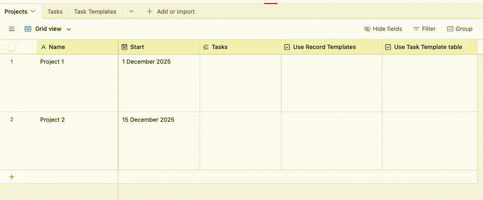

You’ll want to have a list of tasks to use as a template, but your automation should duplicate these tasks for each individual event.

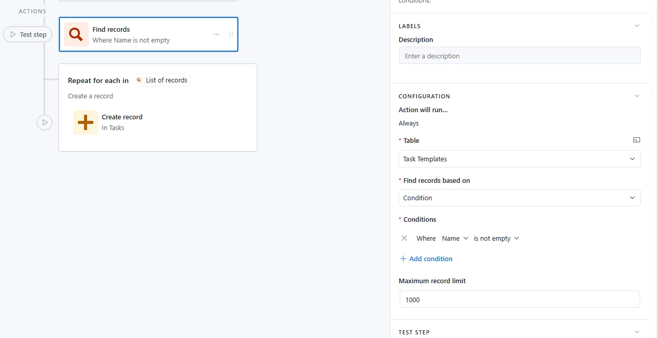

An easy way to set this up would be to use “find records” step, followed by a “repeat for each” step.
Find all records in “Task Templates” (I put this in separate table for this example):

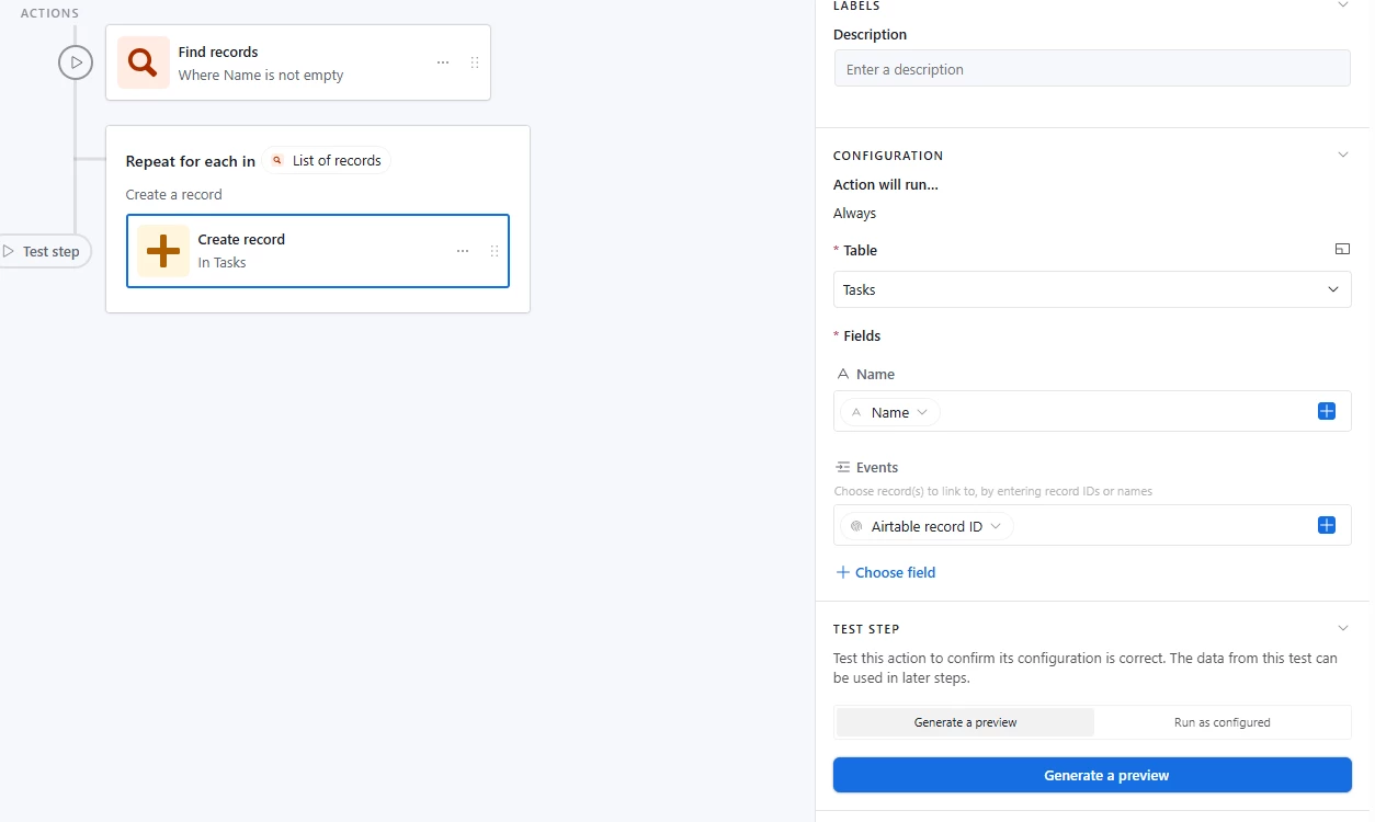

For each record in Task Templates, create a new record in the “Tasks” table. Link that new task to the RecordId of your triggering event:

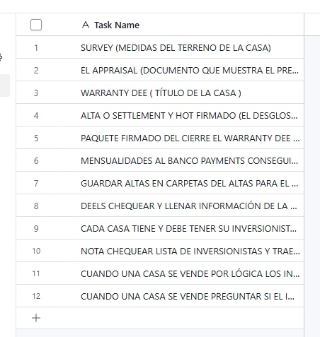

Hi ​@Emily.Ann! I did something quite similar for a client (Real Estate company) which works in both worlds “Data” and “Interfaces”.
When they “Add” a new property, several actions are taken and one of those is creating a list of Admin Tasks. Here is how I did it:
  1. As ​​​​@DevonK said, you first need a template of tasks, in our case the only field I need to replicate is the Task name:

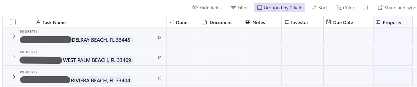

  2. Then this is how the Admin Tasks table looks, it’s grouped by the linked record “Property”:

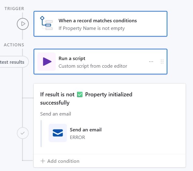

  3. And the magic is here in the Automation, I have this simple workflow:
    The scrip is huge but the part that performs that duplication from the “Admin Tasks Template” table to the “Admin Tasks” table is this one:

    3. Lastly, always the error handling :)
        output.set('result', '✅ Property initialized successfully');
      } catch (error) {
      output.set('result', '❌ Error: ' + error.message);
Let me know if you have any doubts or comments. Happy to help.

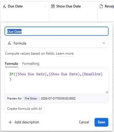

As far as the questions about the dates - I count backwards from my event start date. For Example - ordering electrical has to be done at least 2 weeks before the event, but sometimes the advanced ordering deadline is 3 weeks before the event start date, so I have a formula to give a default deadline but my coordinators are able to input their own adjusted due date depending on show requirements (this has actually been working really well)
If an event is designated as a “Booth Event” the tasks are automatically generated - but the templates aren’t assigned to the specific show… which is what started me into this rabbit hole. But I would love for my coordinators to have the ability to add standard tasks to their other shows from their interface via the click of a button.

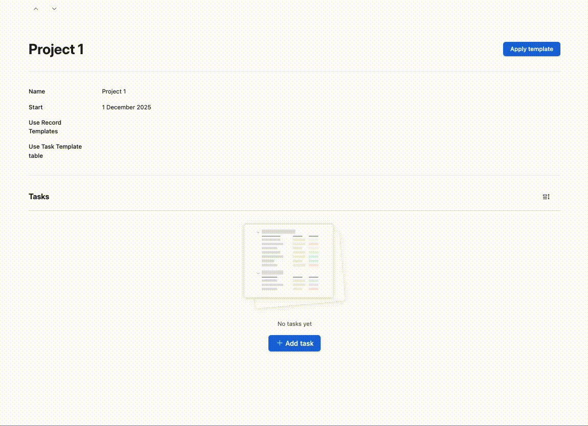

Hm yeah, if you set up the Record Template up with the Tasks linked to the Show record then you’d be able to create an ‘Electrical’ task with a due date 2 days before the Start Date that the coordinators could still edit as it’d be a date field
And yeah, if you created a Record Template with the standard tasks, you could add a button to the Interface?
