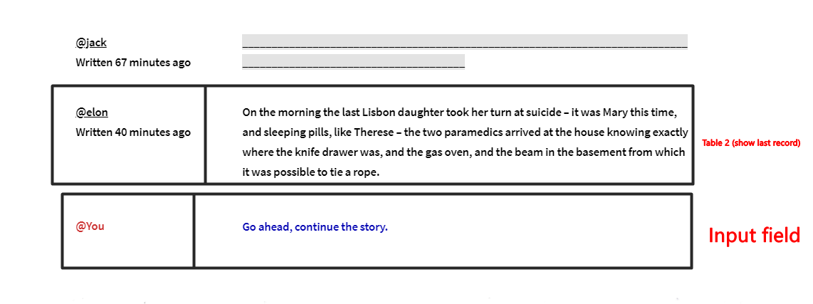

Here’s what I’d like to do.
On my website, I’d like one form (Table 1) to have two fields.
  1. Twitter Handle
  2. Writing Prompt
On my website, a user fills in both fields then the data gets added to Table 1 (in airtable).
When Table 1 fields are filled, another table (Table 2) on the same web page will display the Twitter Handle and Writing Prompt.
However, Table 2 will only show the LAST record (Twitter Handle and Writing Prompt) input from Table 1.
I found this page that I thought would be helfpul: View last record only but I’m unable to make it work.
P.S. I want to prevent users from adding duplicate data.
I’ve added a picture to make things more clear, this is the kind of page I’d like to build. @Jacks data was input earliest. It vanishes once the next user (@elon) adds data. This would be TABLE 2.
@You and “Go ahead…” would be the form where a new user would input their data. Once the user ads the data, it gets shown in Table 2.
