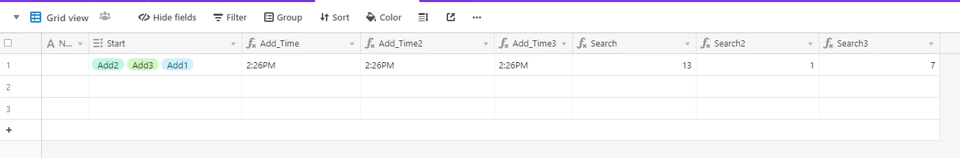

Just for some more context into the timestamp this is what I’m trying to set up.
So, when “Add1” or “Add2” get selected in the Start field I want the time stamped in the Add_Time, Add_Time2 or Add_Time3 fields depending on what is selected in Start. The issue is that when I use LAST_MODIFIED_TIME() the timestamps update across all three fields (as you can clearly see). I want them to be independent of each other. This is the Formula I use for the Add_Time fields:
IF(Search = BLANK(), BLANK(), IF(Search != 0, DATETIME_FORMAT(SET_TIMEZONE(LAST_MODIFIED_TIME(), ‘America/Chicago’), ‘h:mmA’)))
