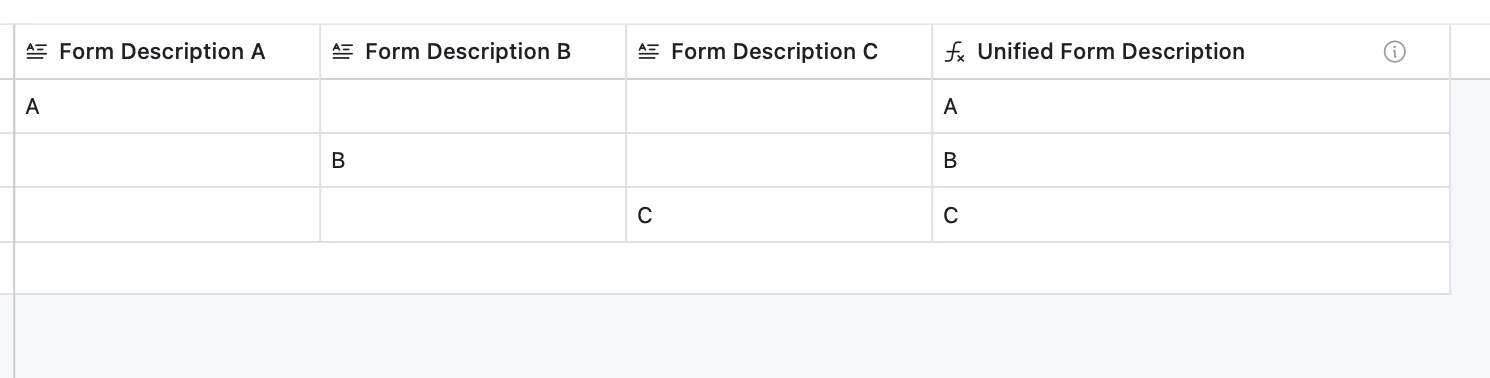

Richard - Simplified Webhooks
Hi ​@avfreedman, thank you for the detailed description that helped me to understand the issue.
Reading through it my approach would be to have a formula field called “Unified From Description” or something similar which does the comparison.
Then use the field agent on this unified field which will never be empty.
This would be the formula:
IF({Form Description A}, {Form Description A},
IF({Form Description B}, {Form Description B},
IF({Form Description C}, {Form Description C}, BLANK())
Would that work in your case? :)
Best,
Richard

Thank you, Richard! This works perfectly for me. I appreciate your help with this!
