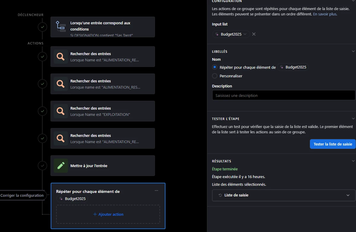

Bonjour,
J’ai un problème dans mon automatisation. Je cherche à faire une boucle, et il me dit que la variable est vide. Et Là je ne comprends pas.

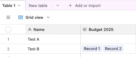

Hm, seems like your testing record doesn’t have any records linked in the ‘Budget 2025’ linked field
As an example, let’s assume this is your data:

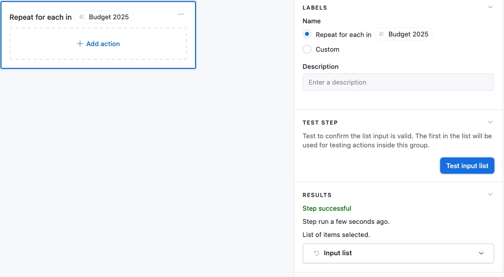

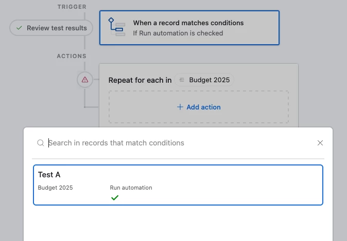

If I select ‘Test A’ in my automation, then my repeating group is empty:

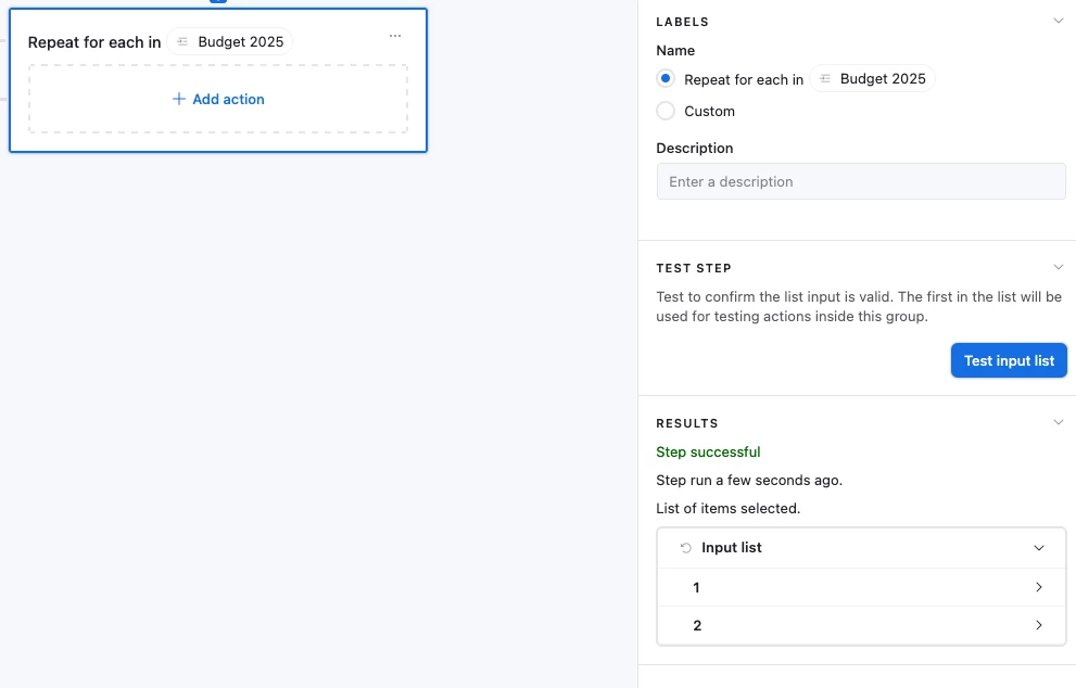

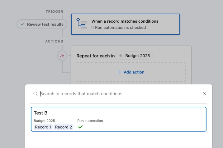

However, if I select Test B, then you can see that there are values in the Input list:
Try selecting a record which has linked records in its ‘Budget 2025’ to see if that helps!
