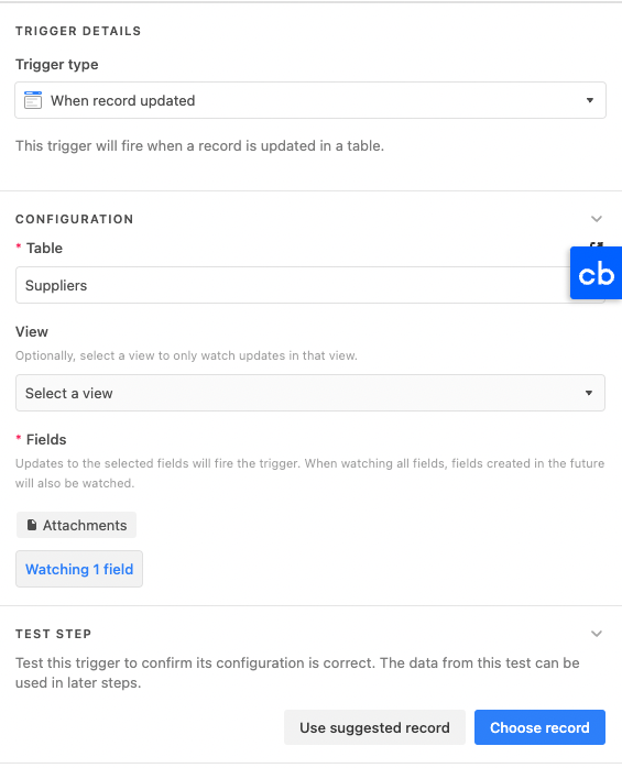

Here is the current trigger:

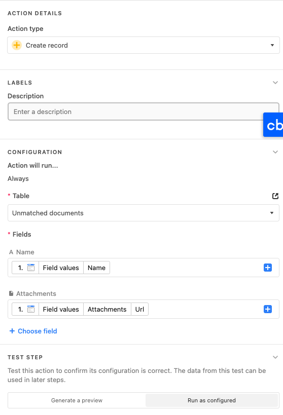

Here is the current action:
