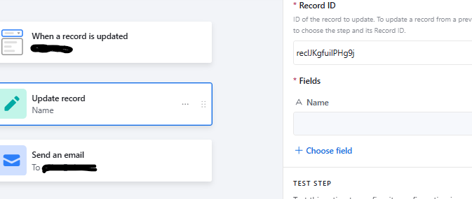

You can create a table for file(s).
Then, add a record with your file. Suppose, primary field in ‘Name’, second field is ‘File’
In your automation, add step with ‘Update record’ and point to that record with some dummy update (like write “ “ in a field ‘Name’)
For this, you need record ID, you can see it in a link when expanding the record, it’s ‘recXXXxxxXXX’ like  reclolwLFghjPHg9j?blocks=hide. Or you can add formula field with  RECORD_ID()
Use this ID to ‘hardcode’ record ID in Update step. Doesn’t matter where you put this step, it can be anywhere before the ‘Send mail’
After that, you can use file from this record in your mail. Just select the proper ‘Update record’ in the left side on your step option.
