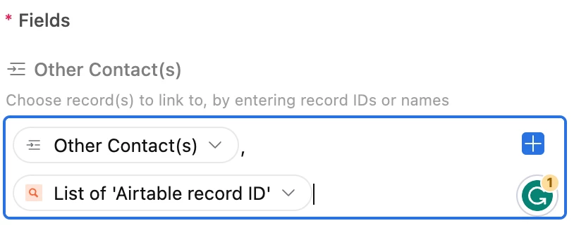

  • April 4, 2023
I think I found a solution to this, at least one that works for me for updating fields without overwriting:
I have a conditional statement that includes "if {field i want to update} is empty" which will simply update the field with the result of the trigger step only and "if {field I want to update} is NOT empty" it will update the field with what is ALREADY in that field, then the result of the trigger, and that seems to take care of the error code
So something like this:
(note what's already in the field MUST go first, otherwise if the result of the trigger is empty it throws an error code anyway)
