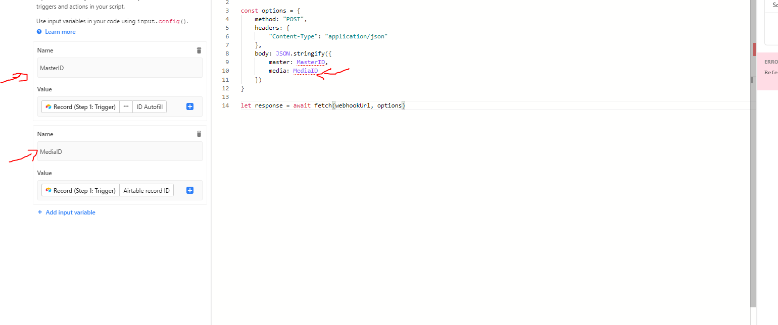

I’m trying to call specific variables in the stringify section, but I’m not sure how to format it. Should I be using ${data.variablename}? Here’s my attempt so far:

First off, beginning variable names with capital letters is discouraged in JavaScript. That’s a naming convention typically reserved for class names, which is why those names are colored differently in Airtable’s script editor. It’s recommended to use a lower-case letter to begin variable names.
The main issue, though, is that you’ll need to bring these values in using the input.config() mechanism. My example above was focused on the fetch call itself, which is why I left that part out. Somewhere above the code that I used, you could do something like this (assuming the variable names are changed per my first comment):
const {masterID, mediaID} = input.config()
That will assign both variables to the value of their respective counterparts in input.config().
Then your options variable setup should work with those new variable names:
const options = {
    method: "POST",
    headers: {
        "Content-Type": "application/json"
    body: JSON.stringify({
        master: masterID,
        media: mediaID
Your concept will definitely work with some minor tweaking. Passing in parameters via the URL is a GET request, but Airtable webhooks must be called by passing the data as JSON via a POST request. Here’s the basic setup:
const options = {
    method: "POST",
    headers: {
        master: masterID,
        media: mediaID
  • July 23, 2021
