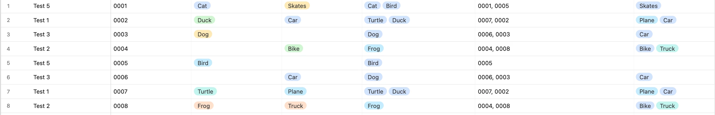

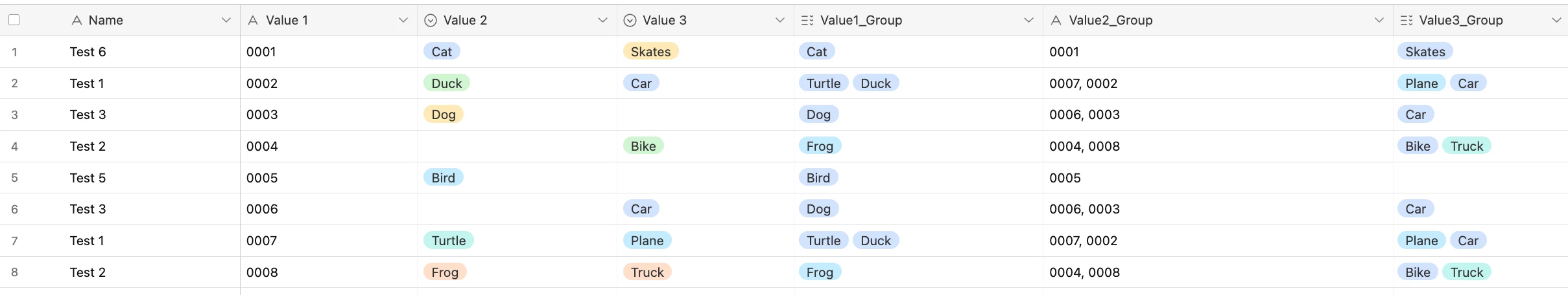

So in the attached example if I change record 1 (Test 6) to (Test 5) the automation will update record 1 to add the values from records 5 ...
Record 1 - Value1_Group to CAT and BIRD (added BIRD)
Record 1 - Value2_Group to 0001 and 0005 (added 005)
Record 1 - Value3_Group to Skates (no change)
I also want it to also rescan all the records and update accordingly so in this case records 5 would get the new record 1 group values
Record 5 - Value1_Group to CAT and BIRD (added CAT)
Record 5 - Value2_Group to 0001 and 0005 (added 001)
Record 5 - Value3_Group to Skates (added Skates)
Screenshots of first bulk record update and 2nd with only record 1 update for demo purposes.

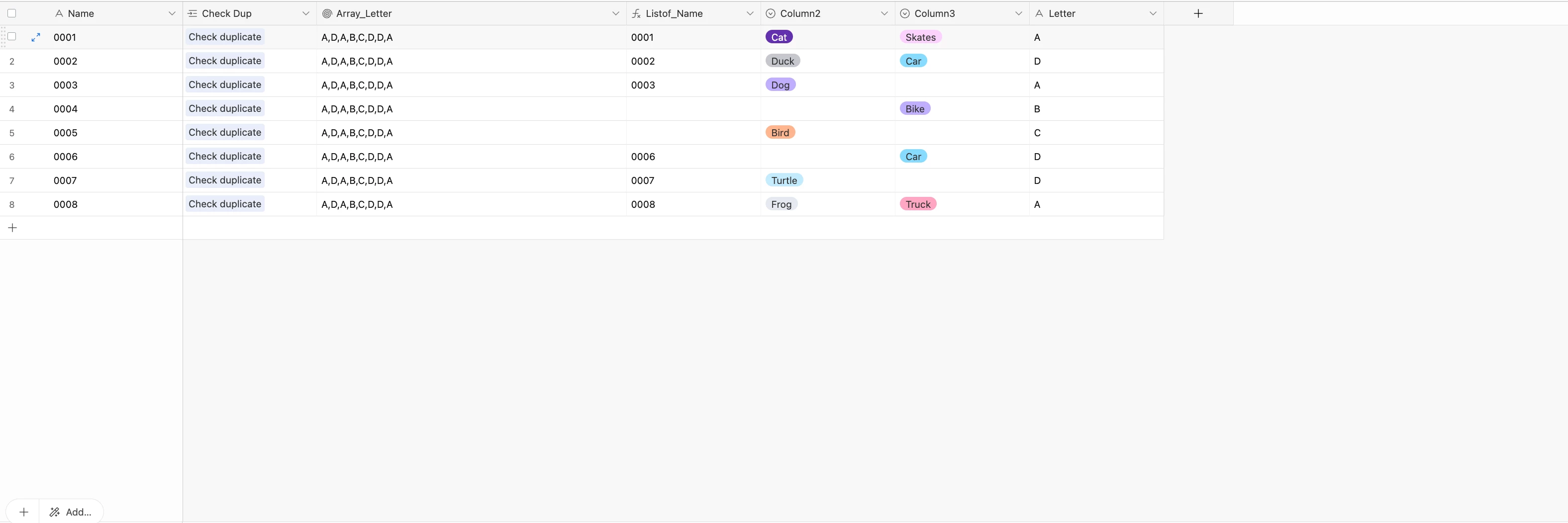

Table 23  - is the data.
  • Check Dup = Link between tables
  • Array_Letter = Rollup from [Table 23 copy]

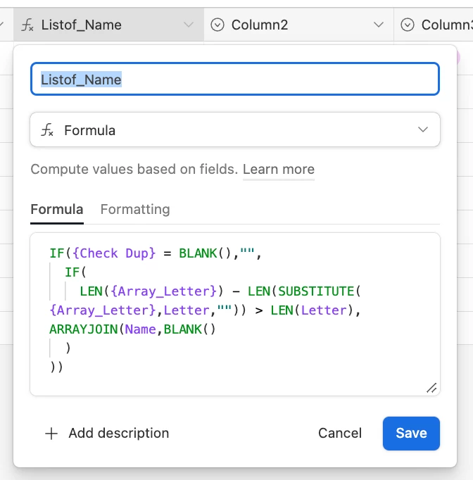

  • Listof_Name = Is a formula field that I'd like to be an ARRAYJOIN of all the {Name} that have duplicate {Letter}. Formula below plus screenshot...
    IF({Check Dup} = BLANK(),"",
    LEN({Array_Letter}) - LEN(SUBSTITUTE({Array_Letter},Letter,"")) > LEN(Letter), ARRAYJOIN(Name,BLANK()

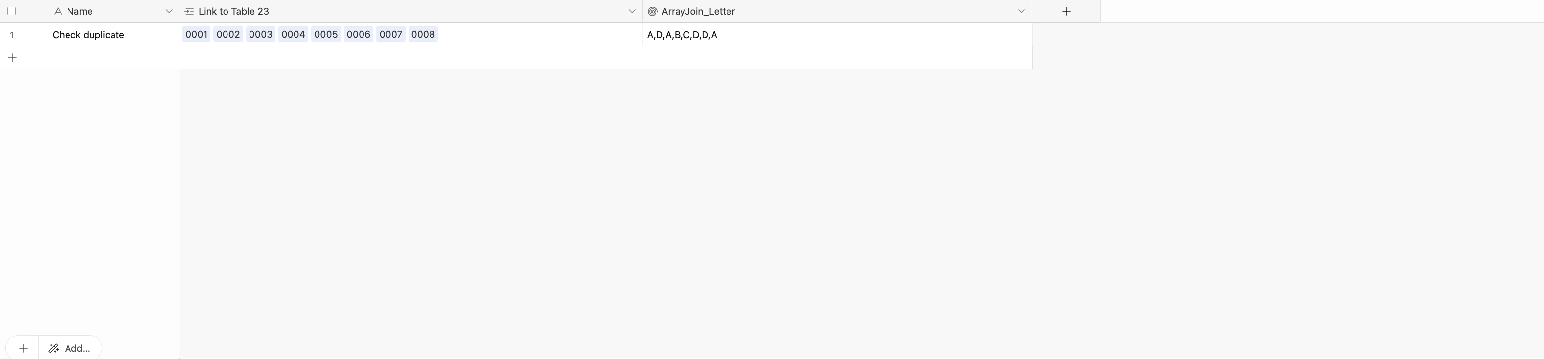

Table 23 copy - is the duplication checker
  • Link to Table 23 = Link between tables
  • ArrayJoin = Rollup from [Table 23] that creates a list of {Name_Group}
