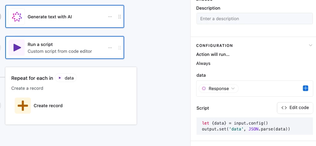

  1. Create an automation with an Omni step that takes the text in “Paste” and get it to output an array of names + titles
  2. Feed this output into a Run a Script action to convert it to an actual array so you can use a repeating group on it:
    1. let {data} = input.config()
      output.set('data', JSON.parse(data))
    2.
  3. That ‘Create Record’ step will create a record in a new ‘Tasks’ table where it’ll have the name of the person and the title

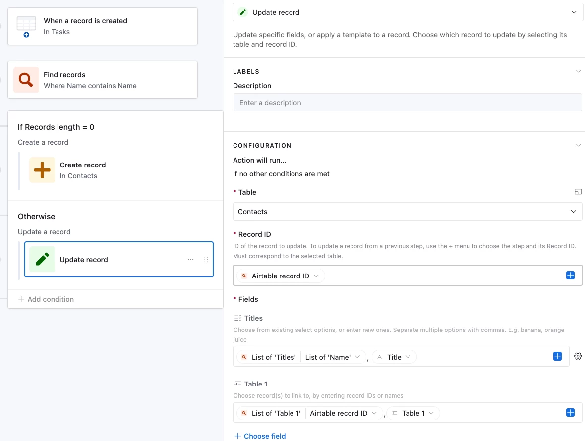

  4. Create another automation that’ll trigger whenever a record gets created in Tasks, and its action will be to:
    1. Find a record in Contacts that has the same name
      1. If one exists, link that record to the original triggering record from step 1

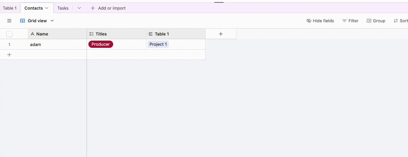

        1. You’ll need to add the title here as well to handle that title edge case, and for this you’d just do an ‘Update record’ action. You can just do it like the screenshot below, if the option already exists in the ‘Titles’ field it just gets ignored
        2.
      2. If one does not exist, create a new Contact record and link it to the original triggering record
You can also hire me to handle this for you if you’d like!

Yeap pretty much!  The limitation we’re working around is that we can’t have a Repeating Group and Conditional Logic in the same automation; ideally we’d have the automation loop through each of the names and titles, look for a contact, and then either create one or link it, and this Tasks table allows us to do that by:
  1. Creating one record per name / title
  2. Automation triggers per record and has conditional logic

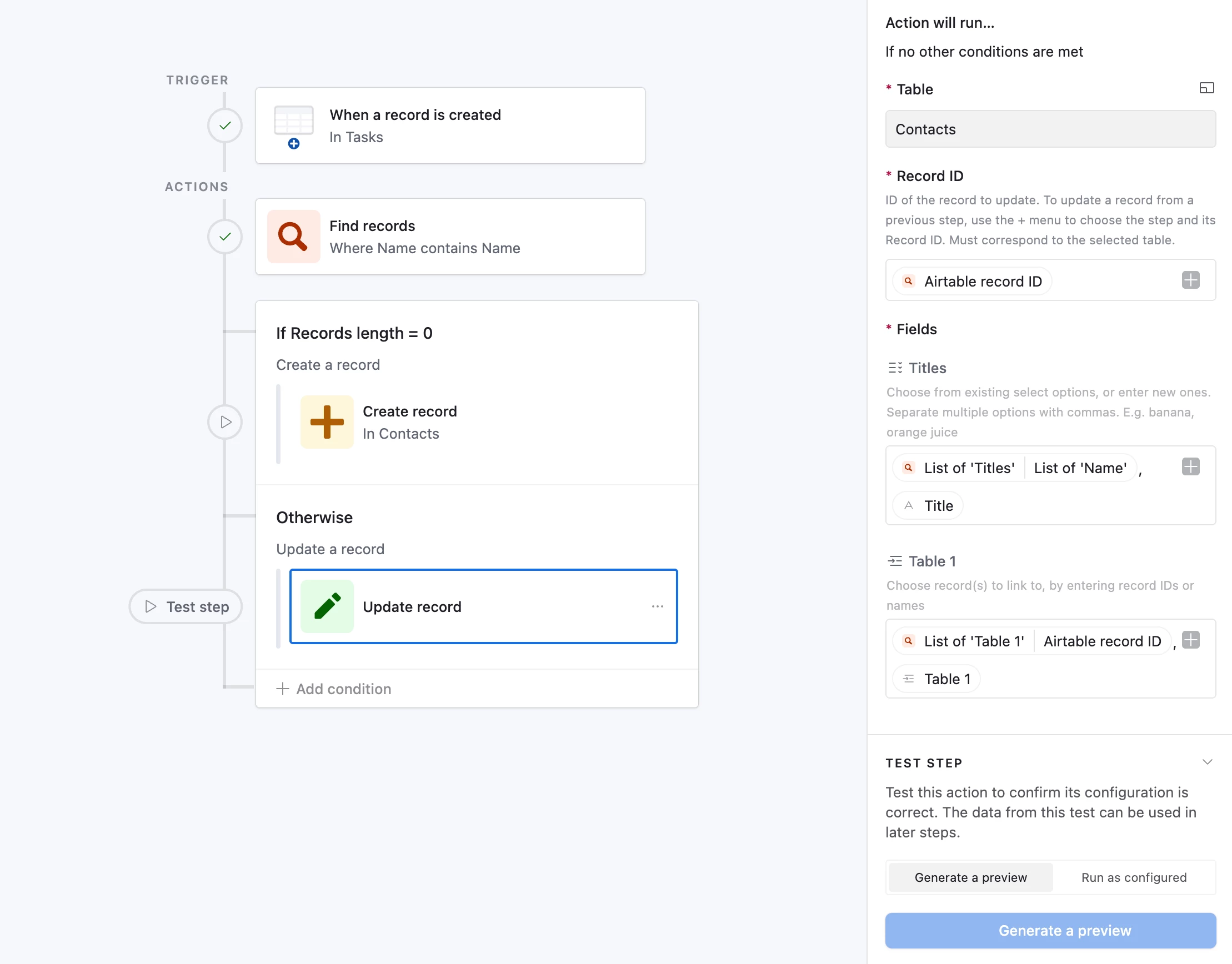

Just started a Team subscription and I’m currently working on getting this set up! I’m most of the way there, but I’m running into something I don’t quite understand when it gets to the “Update Record” step of the second automation:

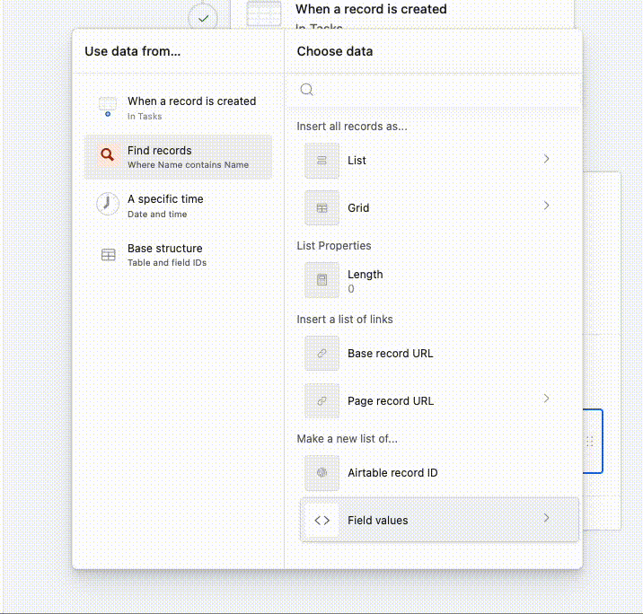

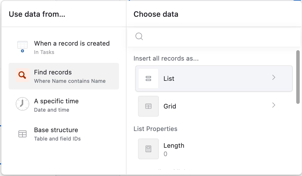

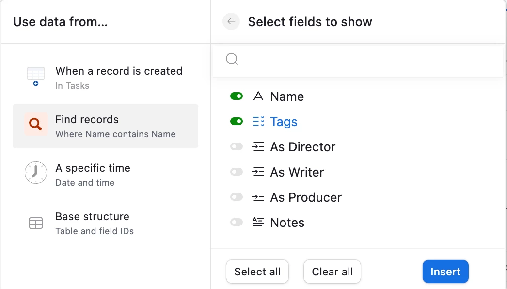

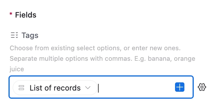

Under “Fields” in the sidebar, how did you enter “List of ‘Titles’ | List of ‘Name’” and “List of ‘Table 1’ | Airtable record ID”? And what exactly do those entries mean/how do they work?
This is what I see step-by-step when I try to do the same thing - it ends up looking different from what I see in yours (last screenshot). I’m not sure if I’m basically doing the same thing and it just looks different, or if I’m clicking on the wrong options.
Ah here’s a gif.  We have to scroll down and select ‘Field values’ followed by the field we want and then the Name of the field, as opposed to the option ID or color:
Those variables indicate either:
  1. The compiled list of Title values from all the found records
  2. The compiled list of record IDs from all the found records
And so we’re looking for all the relevant, compiling their information, and updating the original record with their data

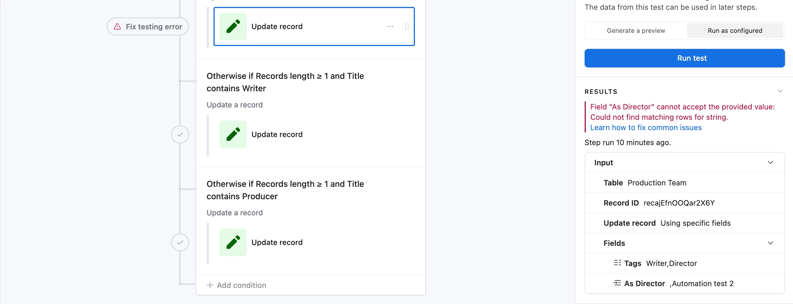

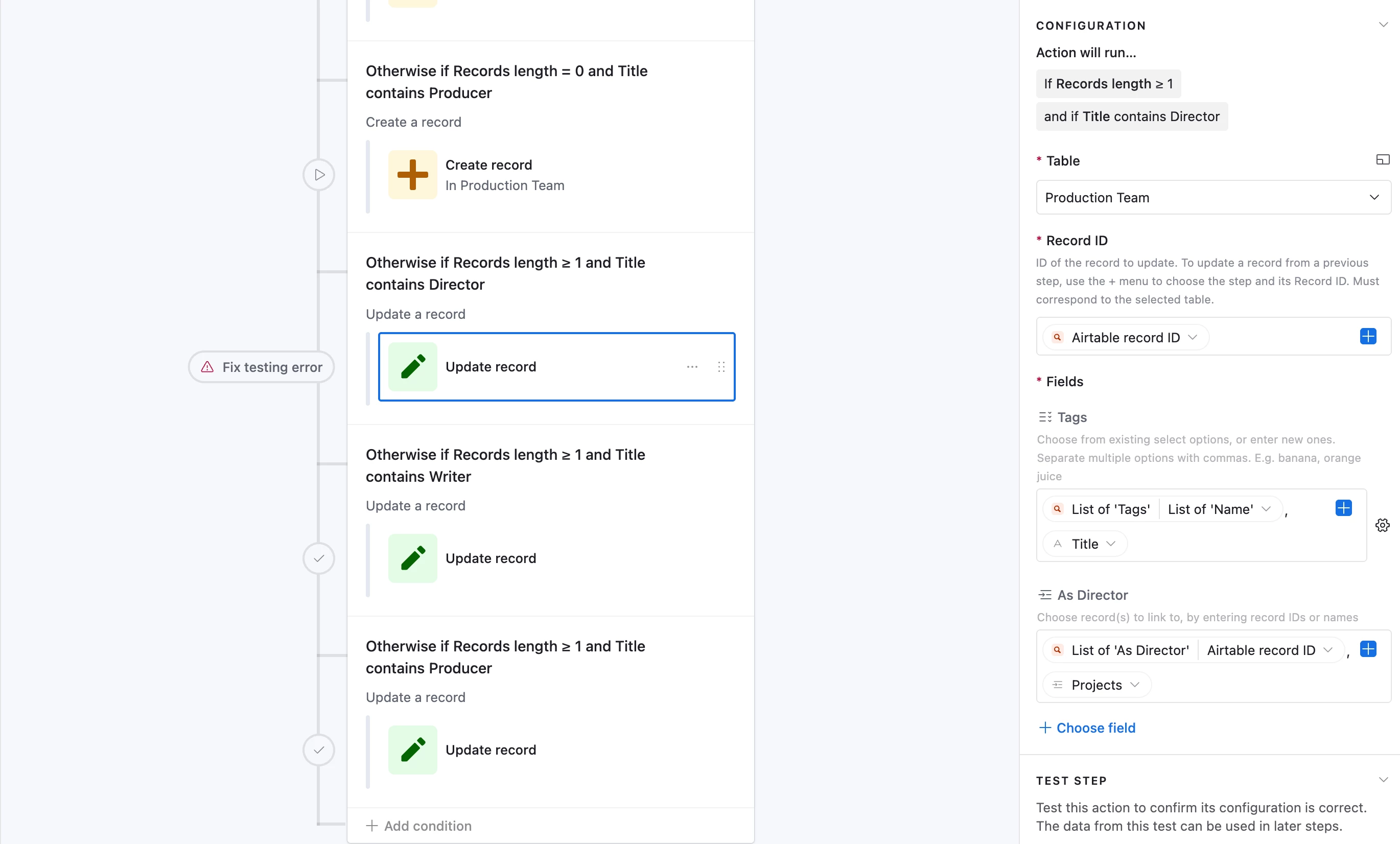

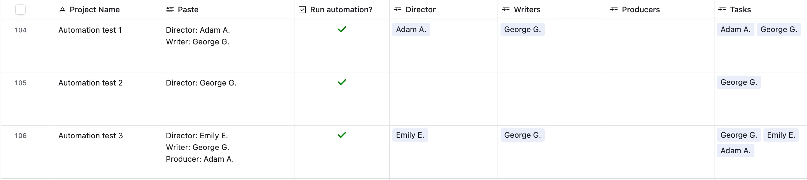

Awesome, got it! Thank you! I have the version you made up and running now, but I’m trying to modify it a bit so that the automation will also put the names associated with each projects the into different fields in the Projects table, according to their titles. I thought I had a good setup, and it works great for creating new records, but when it comes to updating previously existing contact records with new titles/projects, I’m getting an error. Is there something obvious that I’m missing here? Or is this just getting too convoluted for an automation to handle? The only difference between your configuration in this one (at least as far as I can see) is the condition on which this step runs. The condition check runs fine, but then it doesn’t update the record.
There’s the configuration of that step, and the error message when I run a test.
And here’s what it it looks like in the Projects tab when I try to run the automation. Anyone who has a role that is different than a role they’ve had before will not be added - so George is correctly added as a writer to test 1 and 3, but not as a director to test 2. And Adam isn’t added a producer to test 3.
  • Nov 2, 2025 12:21 AM UTC
I’ve figured out why this is happening, though I’m still messing around to see if I can fix it - since George G. did not yet have any other entries under “As Director,” [List of ‘As Director’ | Airtable record ID] is null, and causes an error. So if I remove that the test works, but then of course it wouldn’t correctly append the list if there are later entries where he is a listed as a director.
Ah hmm, I’m not quite sure I’m following the business logic, so sorry.  If it helps, the conditional is the thing that handles this error for us, it basically does:
  1. If ‘Director’ is empty, just put in the new link
  2. If ‘Director’ isn’t empty, combine the old links with the new link and put it together
And so the surefire way of fixing the issue is to create one automation per linked field.  I think you may be able to add in different conditionals to your existing automation too but I’m not really sure, apologies
