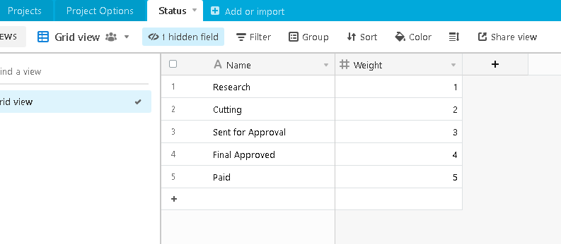

Hi @Evan_McMahon
I think I have a way to do this, there may be better options but this works.
First create a new table called Status, Create 5 row and put the 5 status options in, then create another column in that table called Weight, number them 1-5.

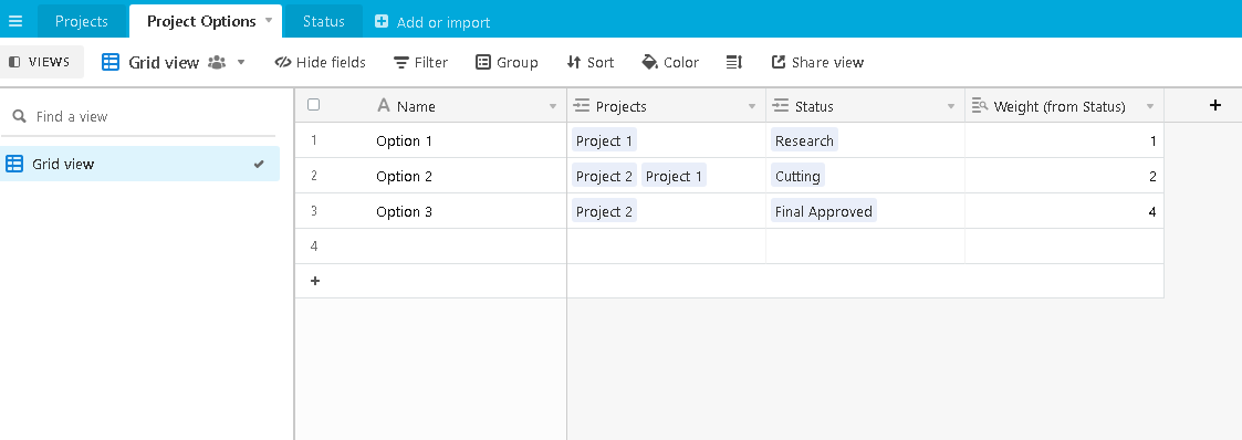

Then in Project options, change the single select to Link to the new Status and Lookup the Weight

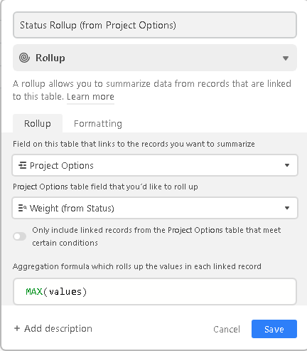

In the Projects table add a column that is a Roll up of the Weight using Max(values)

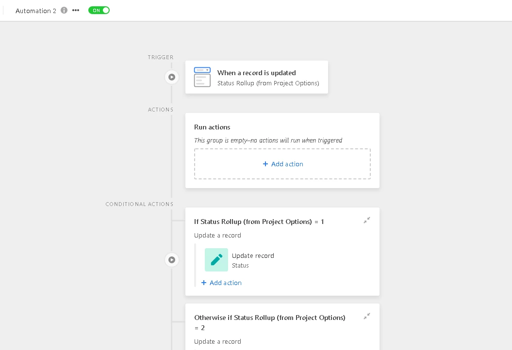

Now create an Automation with conditional options for each weight to Update the Project status
