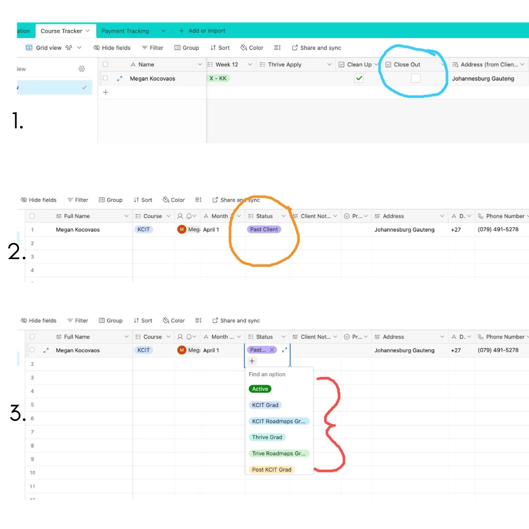

Hi Yall!!
So I am tying to add in an automation that uses a check box being marked as "true" as a trigger in TABLE 1 to add one of my multiple select options in TABLE 2.
An example of how I would need it to work:
  • Table 1: Check box is marked as "Checked/True"
  • Automation kicks in
  • Table 2: one of the multiple selectable items in the column I need to select is added
Trigger: Checkbox is checked in Table 1
Action: Tag is added in Table 2
Is it possible to add in automations that work across multiple tables?
Any idea how I could build this automation? My main issue is coming into selecting the correct record ID?
Any help would be seriously appreciated!
Thank you!
Surething 🙂 the following images have been added below:
1. Table 1: I have circled the checkbox that needs to be selected in order to trigger the automation in blue
2. Table 2: I have circled the column that needs to be updated in orange
3. Table 2: I have highlighted the options that will be available to add as an action to this automation. So when the automation runs successfully, "KCIT Grad" (as an example" needs to be added to the cell as one of the multiple select items 🙂
Hope this helps!
Thanks!  It looks like your two records are linked together, so I would try:
1. Create a lookup field in Table 2 to display the "Close Out" field value
2. Create an automation that will trigger when the lookup field in Table 2 of the "Close Out" field is ticked
3. In the automation, give it an "Update Record" action to update the "Status" field with the option that you want
Hm how do you know which record in Table 2 to update?  Could you provide screenshots of both tables and the relevant fields?
  • Apr 9, 2024 1:40 PM UTC
Hope this helps!
Hope this helps!
  • Apr 10, 2024 9:47 AM UTC
SO CLEVER! Thank you!
