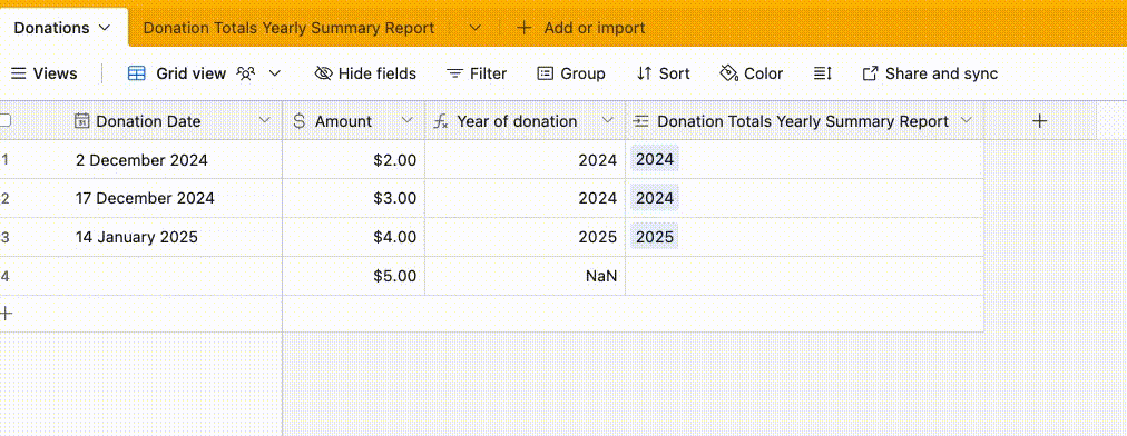

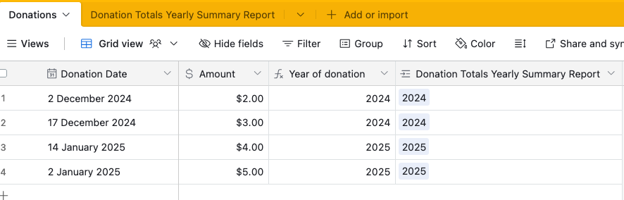

Does this look right to you?
If so, check out this base

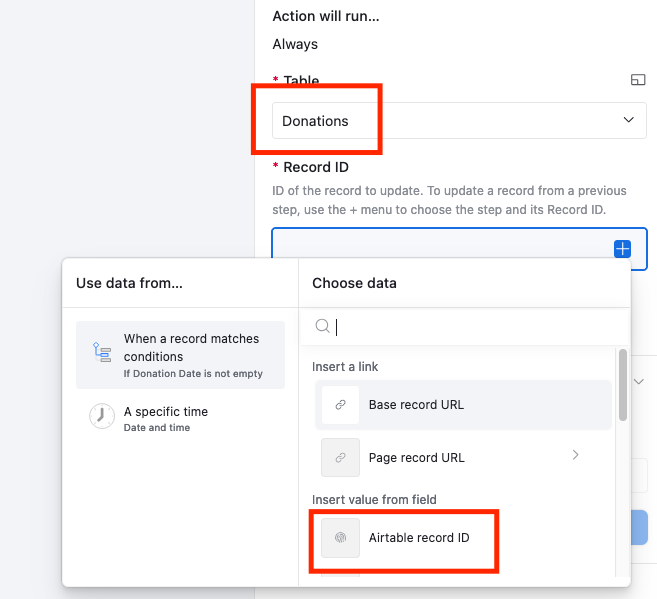

To set it up, you'll have an automation that triggers when the 'Donation date' field is not empty.  (Whether this trigger makes sense depends on how your data gets keyed in though, so lemme know if this bit gives you issues where the automation is triggering too early or too often or something)

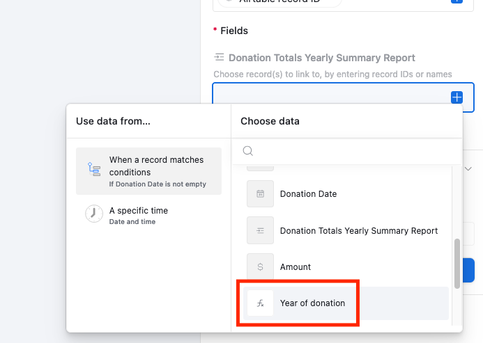

Then you'll use the Update Record action you mentioned on the 'Donations' table and put in the record ID of the triggering record:
In the linked field to the Donation Totals Yearly Summary Report table, we put in the 'Year of donation' field value, which outputs the year value of the 'Donation date' field' with the following formula:
YEAR({Donation Date})
And this is it working:

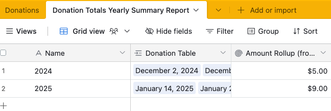

re: All the work is done no the donations table. Because the donations table and the summary table are linked, when the donations table is updated the summary tables automatically updates too?
Yeap that's right
re: Because when I look at the automation in your sample base, I only see references to the donations table and not the summary table. It is a little confusing not to have to explicitly name the summary table and fields. Am I on the right track?
Yeap you're on the right track!  We're updating the Donations table to create the link to the Summary table

Well, now it makes sense. It is working on both sides with one small idiosyncrasy. The Donations table has the Donation Date (date field) as the primary field. The summary table has Year (single line text) as the primary field. Rightnow it is requiring me to add the year to the primary field manualy. Is it possible to have the automation add the new year every year? IS this clear? Thanks, Scott
Actually, you don't need to add year manually
Each time you are trying to put value in a linked field, at first at tries to link to a record with that value.
If it cannot find that, it will auto-create a new record with that value in primary field.
Such behavior can be used for many purposes: find duplicates and their number, get a list of unique values, create pivot table etc.
Imagine you have only Donations table. You create new linked field and choose 'to a new table'. Field created and empty. Then you can copy-paste whole column 'Year of donation' into linked field. When you switch to the new created table, you will see it populated will unique list of all years you had just pasted in field.
Note: auto-creation not works if you make primary field a formula

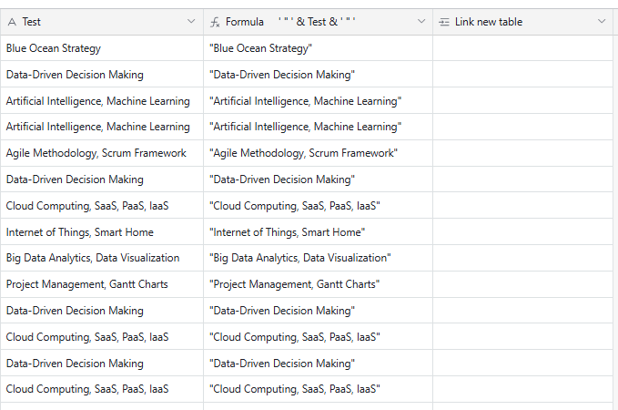

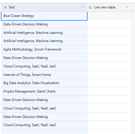

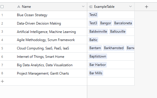

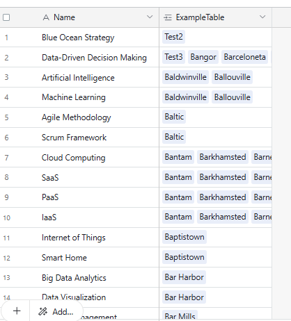

Important Note: Values with commas or ampersands can cause issues as they're interpreted as multiple entries. To avoid this, wrap these values in quotation marks before inserting them.
I think, it's better to show than explain.
The problem:
Possible solution:
