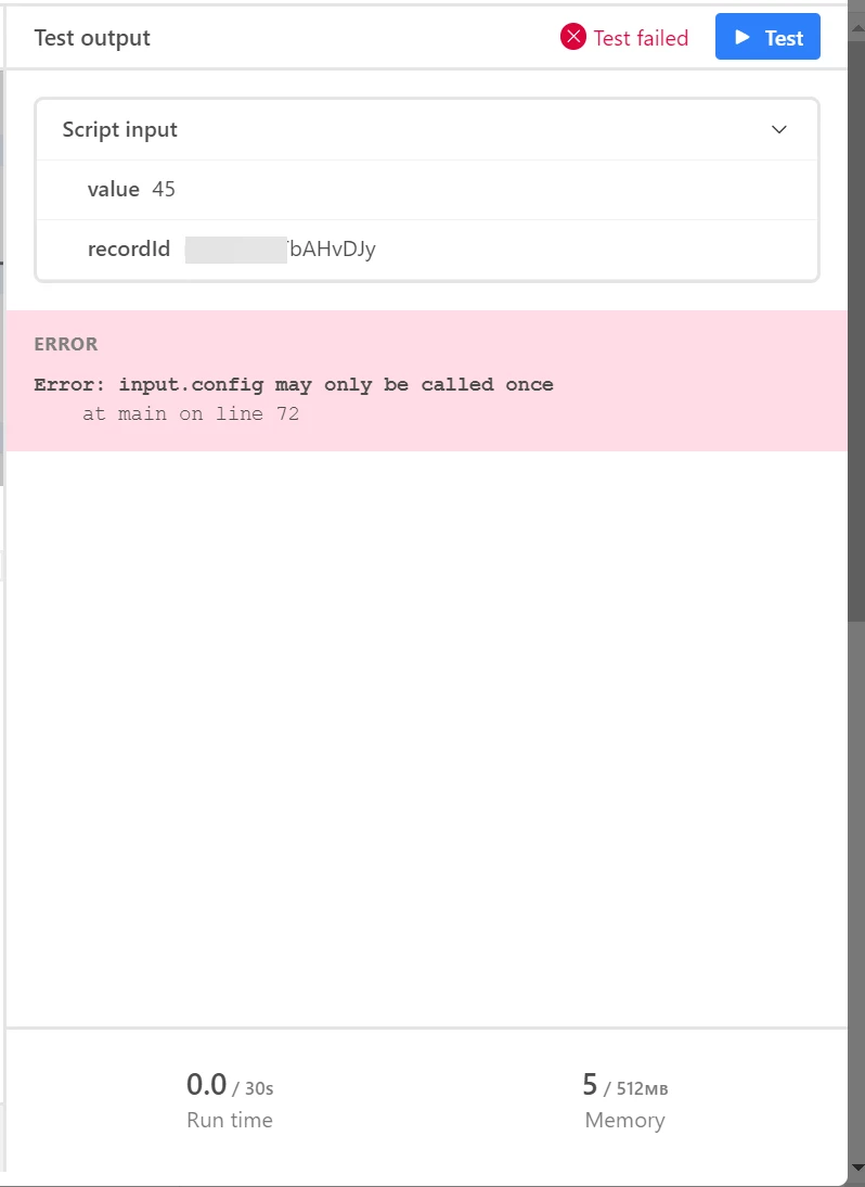

dilipborad
Forum|alt.badge.img+23
  • Sep 30, 2023 5:24 AM UTC
Use variable-based code style like
let inputConfig = input.config(); // Make sure that input.config() should be called only a single time in a script let recordId = inputConfig.recordId // Then use this line with delete function await table.deleteRecordAsync(recordId);
See the attached image as well.
I hope this helps.
  • Sep 30, 2023 11:51 AM UTC
That script will not work. The script below is a working deletion script, if you define myRecord as shown in the screenshot below:
let recordId = inputConfig.myRecord;
let table = base.getTable("Type Your Table Name Here");
  • Sep 30, 2023 3:45 PM UTC
Hi ScottWorld, thank you for your response but I'm still getting the same errors see log below. Is recordid specified outside of the script maybe?
ERROR
TypeError: Invalid arguments passed to table.deleteRecordAsync(recordOrRecordId):
• recordOrRecordId →
recordOrRecordId should be a Record, not undefined
or recordOrRecordId should be a string, not undefined
at main on line 4
thanks
  • Sep 30, 2023 3:49 PM UTC
I hope this helps.
Where does recordid get specified? Thanks.
  • Sep 30, 2023 6:22 PM UTC
You can see it getting set in the left margin of my screenshot.
Alternatively, if you’re having difficulty with scripting and you just want an easy, no-code way to delete records, you can always use Make’s Airtable Automations, which come with their own “Delete Record” action.
There is a small learning curve with Make, which is why I created this basic navigation video to help. I also provide the links to a few other Make training resources there as well.
  • Sep 30, 2023 8:00 PM UTC
Hi ScottWorld, Thanks for the quick response. It's working now and thanks for the links.
