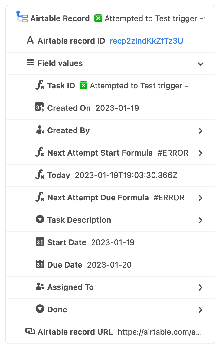

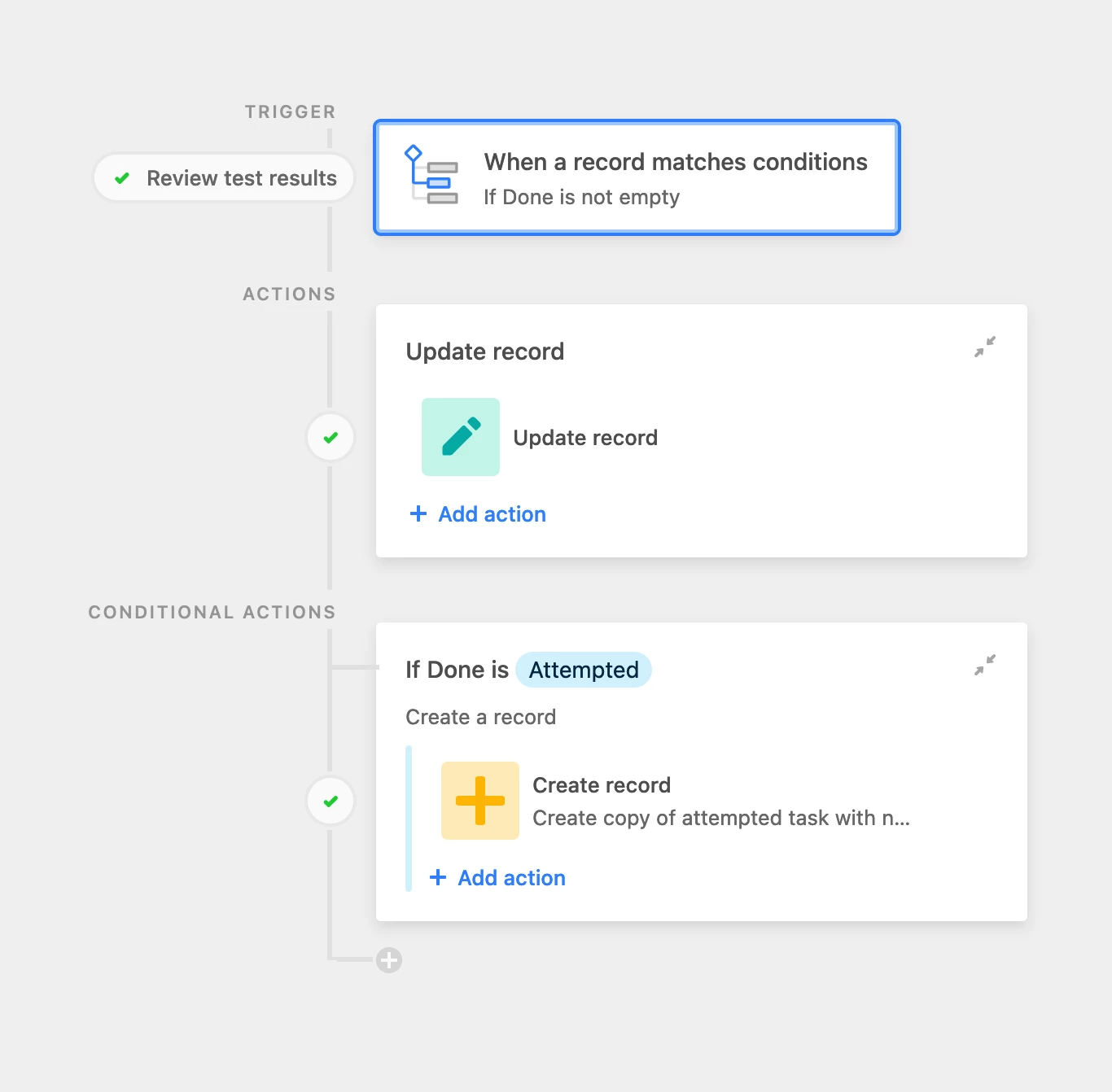

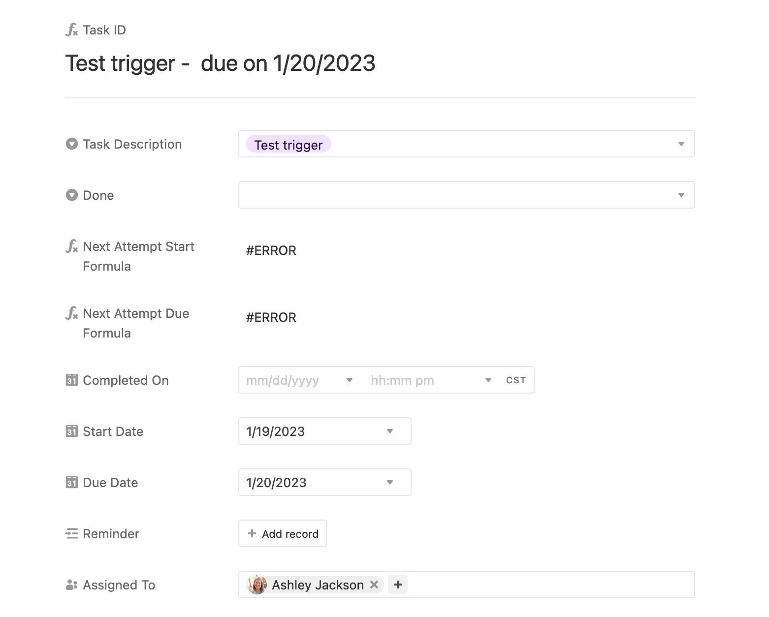

Hi, Thank you for the help!  I did as you asked and here are the screen grabs:
This is the test task I'm using
This is the automation overview:
This is the result of testing the trigger and I think it's where the problem lies:
It seems like the automation is grabbing the value of the formula fields BEFORE the formulas have a chance to update in the first action.  I thought that by ordering them this way, it would process in that order - but I guess not.  Is it possible to delay the create record step somehow?  Any ideas how to make this work?  TIA!
