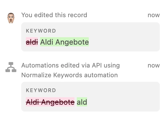

Hi all!
I have a problem that I feel should have an obvious solution: I’d like to set up an Automation that normalizes a string value after input by base collaborators. However, the Automation appears to run too early, catching only parts of the input string. (This behavior is not consistent, though: From time to time the Automation will catch the whole string.)
I selected When record updated as trigger and configured it to watch only for changes in a specific field (in my case: Keyword).
Example from the screenshot: The entered text is “Aldi Angebote”, but the Automations appears to run already after the first letters are typed in, so only “Ald” is used as Automation input.
What’s the best way to solve this problem? Is there a better trigger for this use case that I am missing?

Unfortunately, one simple keystroke is enough to register as an update to the record, because Airtable sees ANY change to the field as an immediate update.
Airtable never waits until the person leaves the field to trigger an automation.
There are 2 easy solutions for this problem:
  1. You can change your automation’s trigger to be based on a checkbox field or a single-select field. These 2 fields are reliable ways to trigger an automation.
    Even better, if you use a single-select field, you can even give status updates about the automation’s progress to your users by using that very same single-select field.
    I give more information on this technique in this thread.
  2. You can use Fillout’s advanced forms for Airtable, which allows you to update your existing Airtable records with a form.
    This method will always work, because it updates records using Airtable’s API. And when you use Airtable’s API, all the fields are updated in one fell swoop.
Hope this helps!

You will need to trigger your automation differently, because unfortunately, Airtable sees any change to the field as an immediate update. One simple keystroke is enough to register as an immediate update. Unfortunately, Airtable never waits until the person leaves the field/record to trigger an automation.
So, in your case, you could create a checkbox field or a single-select field to trigger the automation — these are 2 of the very few reliable ways to trigger an automation in Airtable.
