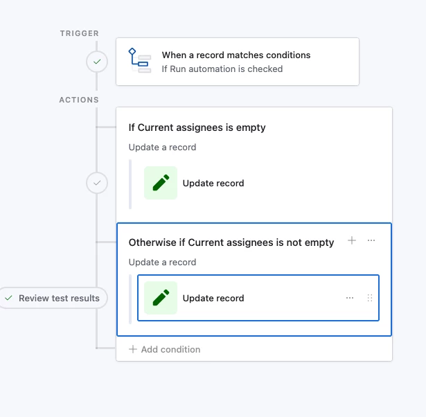

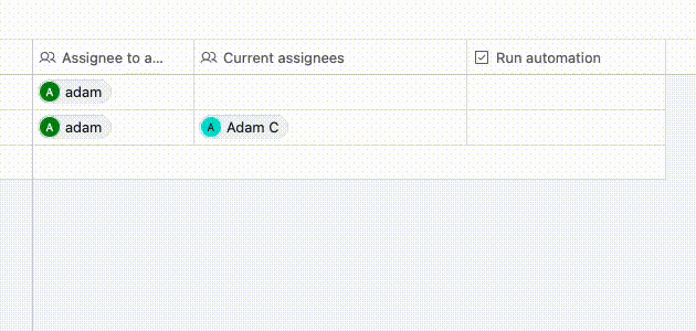

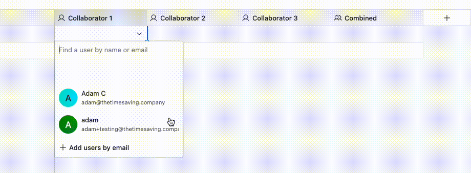

Hello! I’m trying to create an automation that allows me to add someone to a collaborator field without replacing any data that is already in the field. Is this possible?
That is, if 3 people are already in the collaborator field and I want to add a fourth via an automation, can the fourth be added without removing the other 3 that are already in the field?
Does this look right?  If so I’ve set it up here for you to check out
And here’s the automation setup:

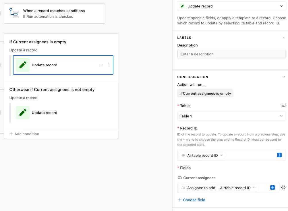

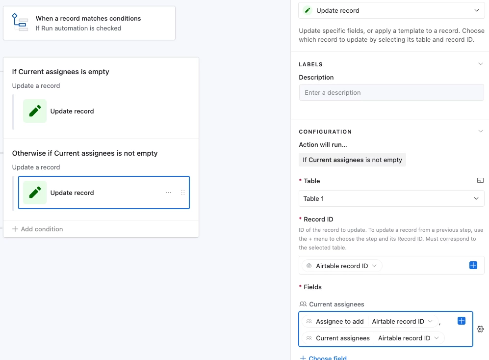

Hey ​@ScottPhillips,
As shown by Adam above, this can be absolutely done by having two fields for Collaborators (e.g. Existing and New),
When updating the value of Existing via automation, you’ll want to:
1. actually map the already Existing value (from the trigger) on the Existing field
2. have a comma
3. map the New value (from the trigger)
i.e. “{Existing}, {New}”
For last, you can also update the New field to make it blank again!
No need for any scripting :D

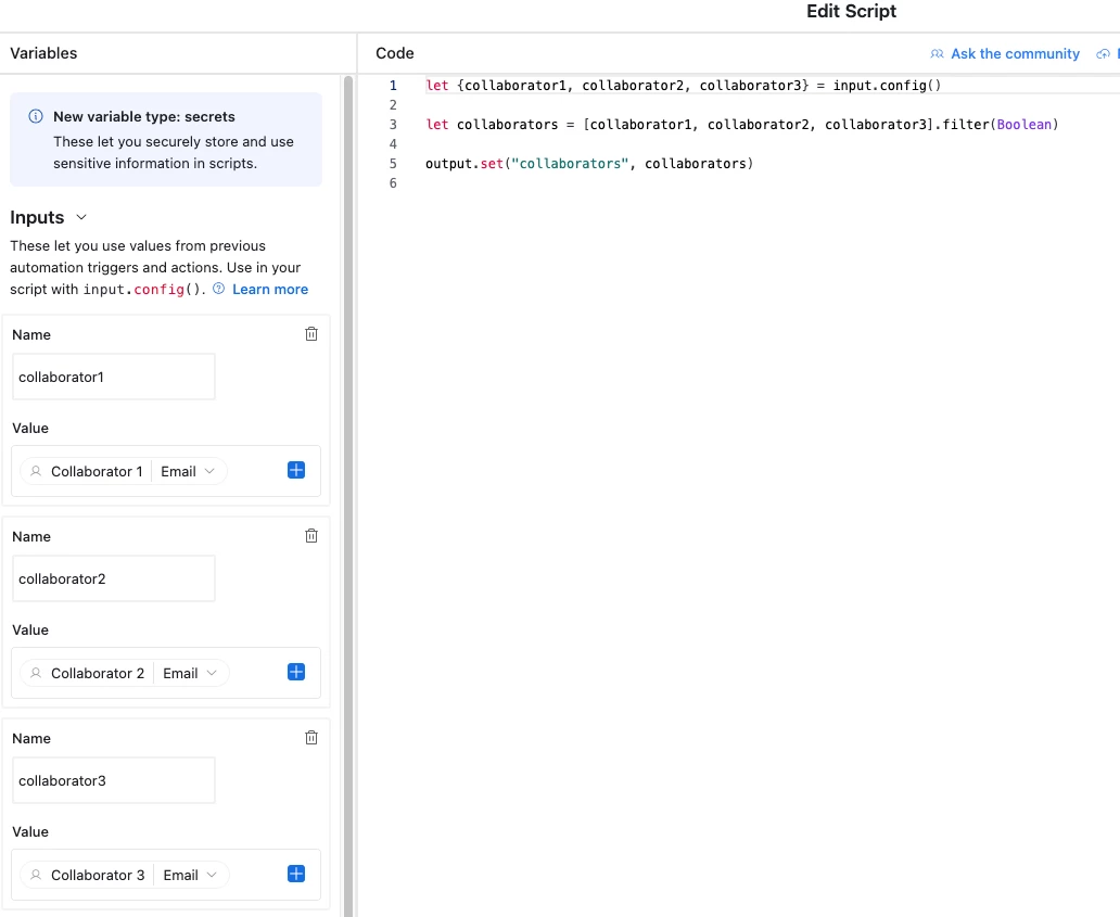

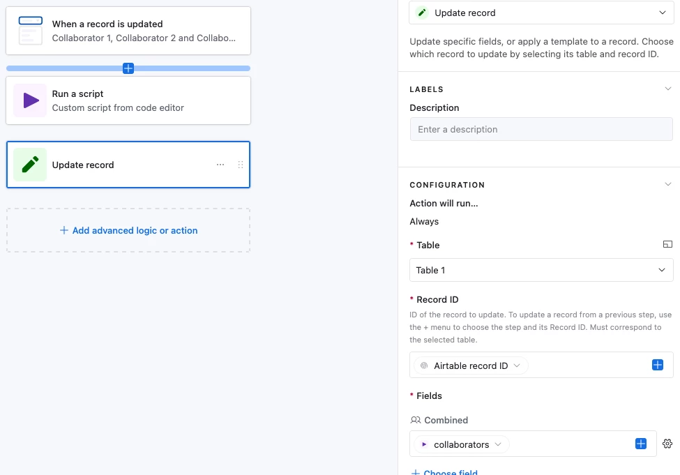

Hm, I think you’d need a script for this I’m afraid. Does this look right?  If so I’ve set it up here for you to check out
let {collaborator1, collaborator2, collaborator3} = input.config()
let collaborators = [collaborator1, collaborator2, collaborator3].filter(Boolean)
output.set("collaborators", collaborators)

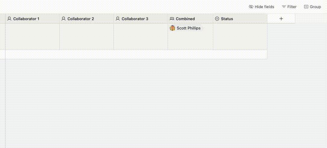

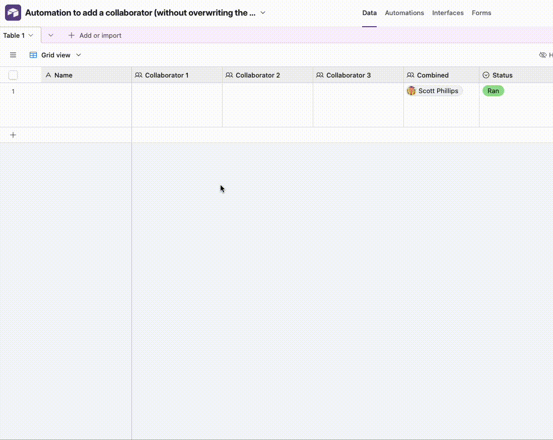

Ah got it, how does this look?
Here’s the script, and I also updated the original base with it:
let {collaborator1, collaborator2, collaborator3, combined} = input.config()
// ensure arrays
let startingValue = [collaborator1, collaborator2, collaborator3].filter(Boolean)
let existing = Array.isArray(combined) ? combined : (combined ? [combined] : [])
// merge, keeping all unique values
let merged = [...new Set([...existing, ...startingValue])]
output.set("collaborators", merged)

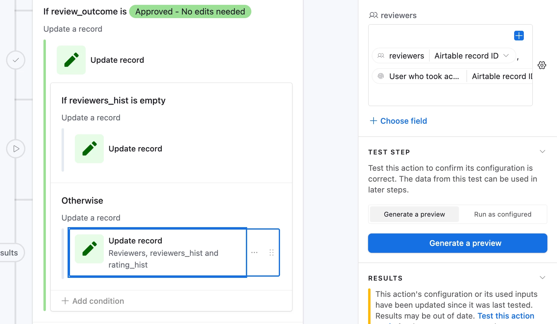

I have an automation which basically replicates what ​@TheTimeSavingCo showed above.
However, mine keep failing seemingly at random.
Briefly, the automation attempts to append the user who trigger the automation to the pre-existing users in a users field (reviewers). I separate them with a comma, as indicated by ​@TheTimeSavingCo.
The error I get is: “Field "reviewers" cannot accept the provided value: Could not find matching collaborator for string.”
I know the user (who took action) input works because I can add it alone to another field, and that always works. My issue is when I try to append it to pre-existing users.
The odd thing is that it sometimes works. I truly cannot figure out what the issue is.
For every single case that fails, I have rerun it in testing mode (within the automation editing interface) and it always works fine.
Any help is much appreciated!

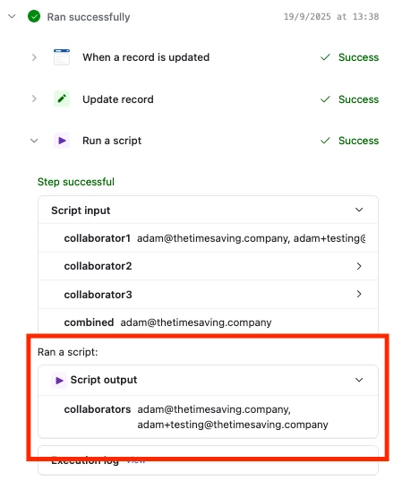

Hi ​@Javier !  Any chance you could DM me an invite link to your base so I can troubleshoot it?  If not, could you take some screenshots of the automation history?

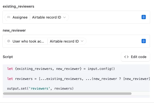

I’m curious as to what the output of the script is:
I’m also wondering if there’re any patterns as to the output of the script and the collaborators in the base, e.g. does it error out on people who only have Interface access maybe?
​@Javier

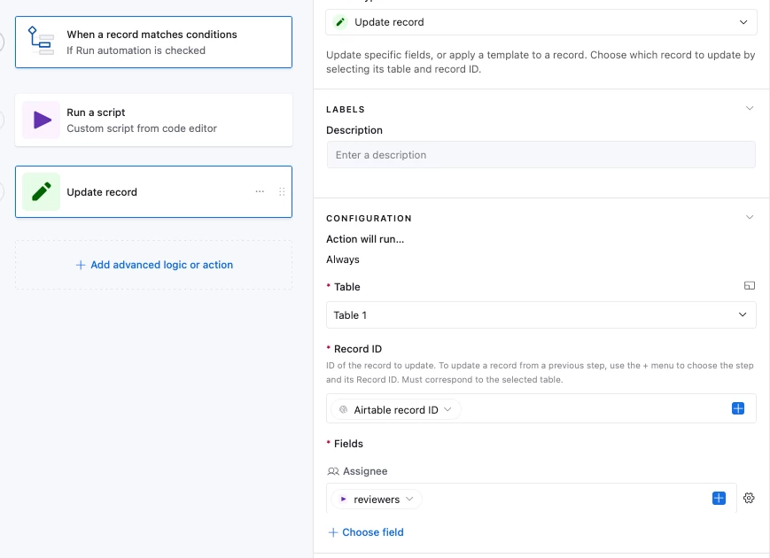

I’ve created a base here for you to check out!  This base has an automation that does the following:
  1. Triggers when field is updated
  2. Appends the ‘User’ field with the user who just took that action
And here’s how the automation looks:
Script:
let {existing_reviewers, new_reviewer} = input.config()
let reviewers = [...existing_reviewers, ...(new_reviewer ? [new_reviewer] : [])];
output.set('reviewers', reviewers)
Script setup:
  • Mar 9, 2026 4:51 AM UTC
Thanks ​@TheTimeSavingCo !
It seems like running what looks like the same automation via the UI vs a script leads to different results.
The automation I set up via the UI would sometimes give me no values for a user field that certainly had users in it. It would even sometimes return them successfully, and other times it would not. Even feeding the input values to my script using the UI would lead to this stochastic error.
My solution was to directly retrieve the user IDs from the script itself (using the getCellValue function), and not from the UI.
