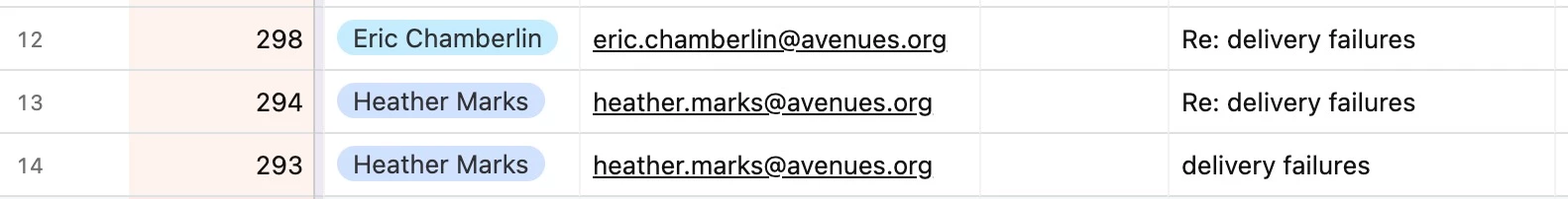

We have an airtable/make.com combination running a help desk/ticketing system. When people reply to their initial ticket, the system assigns a new record. Is there an automation that we could install that would combine the records?

- the above works well. As I stated in the original question - what we would prefer is that when the client replies to the response from out team, that the response gets appended to their original email.

Thank you for your response. My question about searching for an email record would be a match that is an email address but is not a connection to a previous ticket, it could be a separate idea/issue. I think I would have to match to the subject or possibly the 2, email and subject?
