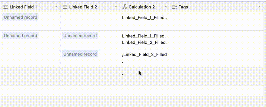

Hm I think if I were you I'd just have a formula field to handle this, and get an automation to trigger whenever the formula field gets updated, and to paste the value of the formula field into the multi-select
e.g. if your logic is the following
 - Linked field 1 = not empty, multi select option "Linked_Field_1_Filled" added
 - Linked field 2 = not empty, multi select option "Linked_Field_2_Filled" added
Then I'd have a formula field that would look like:
IF( {Linked Field 1}, "Linked_Field_1_Filled" ) & "," & IF( {Linked Field 2}, "Linked_Field_2_Filled" ) & ","

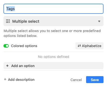

And here's an example of copy pasting the formula field values into a multi-select
Thanks Adam. Having a formula field in the way you expressed was the first approach I implemented. Then I realised that I needed a multi-select list because I am integrating airtable with something else at the front-end and that something else does not allow me to have a dropdown list to select options for filtering records if the options are expressed in a formula.
