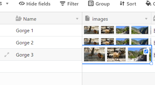

Hi all,
I’d appreciate some guidance on how can I change the filenames of my attachments. I have a table with 500 records. Every record has a name and multiple images (attachments).
The attachments have identical file names in multiple records, e.g I might have a file called 1.jpg in one record, then a different attachment in a different record with the same name of1.jpg.
I managed to find a script that does that, but it changes the name only for one attachment. Ideally, would be to create a rule that adds to the current filename, the name from another field.
e.g: Gorge 1 + current filename.jpg
