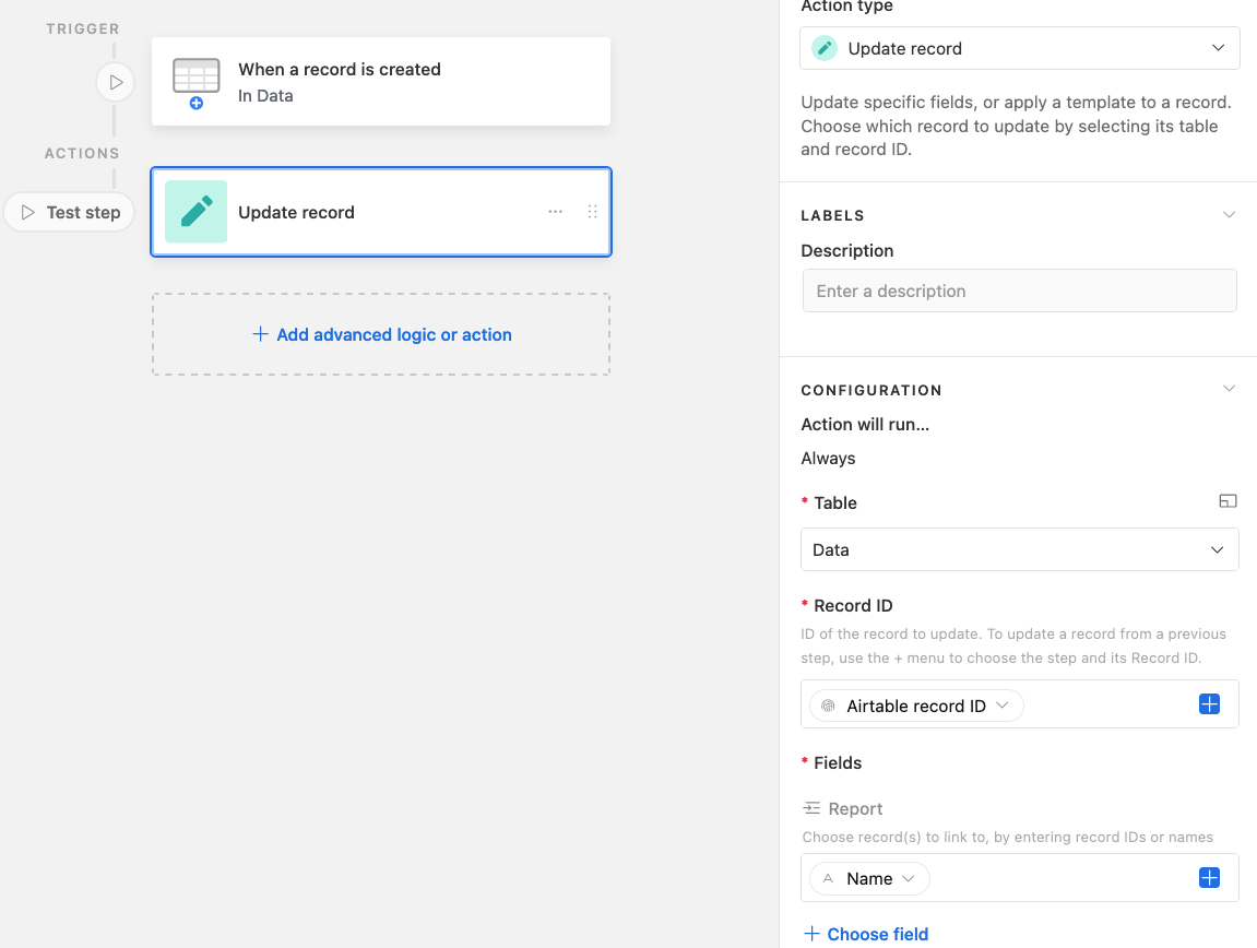

Thanks for your reply,
I have a little problem with the "update" method.
When I create a new row in "Data" the automation immediately creates an empty cell in "Link to Report" without 'waiting' for the data to be written. it's good for pasting data or getting it from another source with an API, but I need to do in manually inside airtable
Hm, for that situation you could just copy the value from the 'Name' cell and paste it into the linked field?
If you need this to be fully automated, you could try using a "Last modified time" field and a formula field to check that it's been 1 minute since the 'Name' cell has been updated and get your automation to trigger off of that

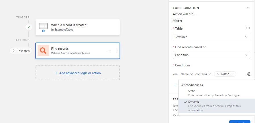

I think using 'Find Records' might be easier.
Just create a step to find 'Name' from trigger record in the column 'Name' of Report table.
The output of 'Find Records' is a list of records (limited to maximum 100)

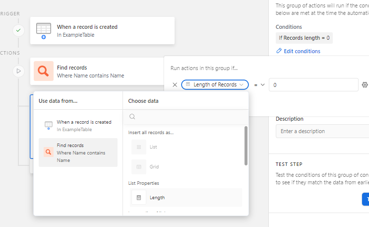

and then add conditional logic - run only when the length of list is 0
Put your desired action(s) inside condition group.
