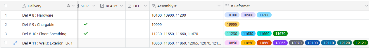

I have a Deliveries table, The idea is when I select a "ship package" [eg.Floor: Sheathing] it pulls up the Assemble numbers with a lookup field - that correlate to a material list on another table. I then have a script which converts that lookup field into a multiple select field. This all functions correctly.

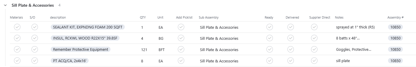

Now my issue is that i want to select a series of boxes ["Ship" "Ready" Delivered"]. The idea being that i have a script [i have zero programing knowledge and have ai write my scripts], That when "ship" is checked the script hunts through the "Materials Table" using data from  the "# Reformat" field and with each record that is found in "Assembly #" to match one of the many possible numbers it checks the "Picklist" box. My script below says it works but it does not check the any boxes.

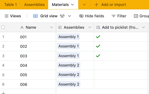

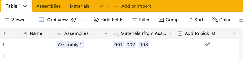

Hmm, I'm not sure if I fully understand your base structure, but couldn't you use lookup fields for this instead by putting a 'Add to picklist' checkbox field in your main table?
And I've set that up here for you to check out
If you did need that 'Add picklist' checkbox to be in the Materials table instead, it seems like you could use a Repeating Group too.  What issues did you face with that that made you use a script instead?
