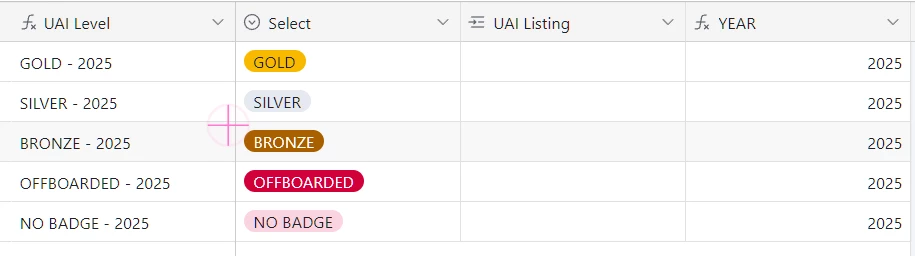

Sean_Lake1
Forum|alt.badge.img+20
Hey all.
I have a table that has a “status” or “level” for users.  The idea is to have the formula update an unique status/level with the year, e.g.,
CONCATENATE(Select," - ",YEAR)
SO what I’d need is Gold 2024, Gold 2025, and then when the year with a formulat: (YEAR(TODAY()) updates, we’ll have 2026 and so on.
Unfortunately, with a formula right now, 2024 cannot be created.
Perhaps an Automation that updates this based on year(today()) ?
Any ideas?

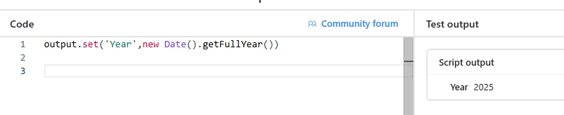

Alexey_Gusev
Forum|alt.badge.img+25

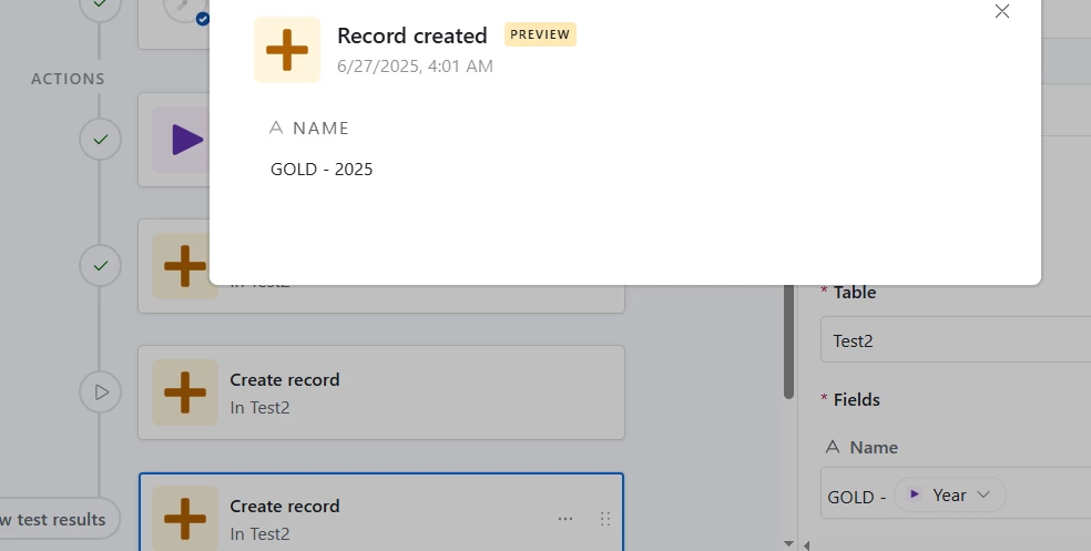

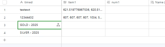

add script step
Create automation for every 12 months starting from 2026-01-01
Set three Create record actions, using value from script step.
When setting starting time, note that new Date( ) is UTC time. Just to avoid cases when, for example, your time is UTC+3, script starts at 02:00 2026-01-01 when UTC is 23:00 2025-12-31 and Year will be still 2025.
With USA time zones, nothing to worry about.

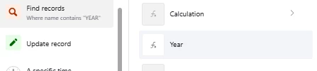

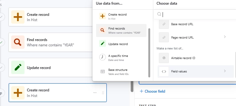

Alexey_Gusev
You can create formula field with YEAR(CREATED_TIME()) and hide it.
then use it’s value instead of script. The trick is you cannot use it directly from ‘Create record’ but you can Find it and the step will re-read values
So, at scheduled time(1):
(2)Create new record with ‘GOLD - YEAR’
(3)Find records containing ‘YEAR’, limit is 1
(4)Update record from ‘Create step’, use …. well, that’s easier to show
use the same value from Find Records for other two ‘Create Record’ steps(5-6)
