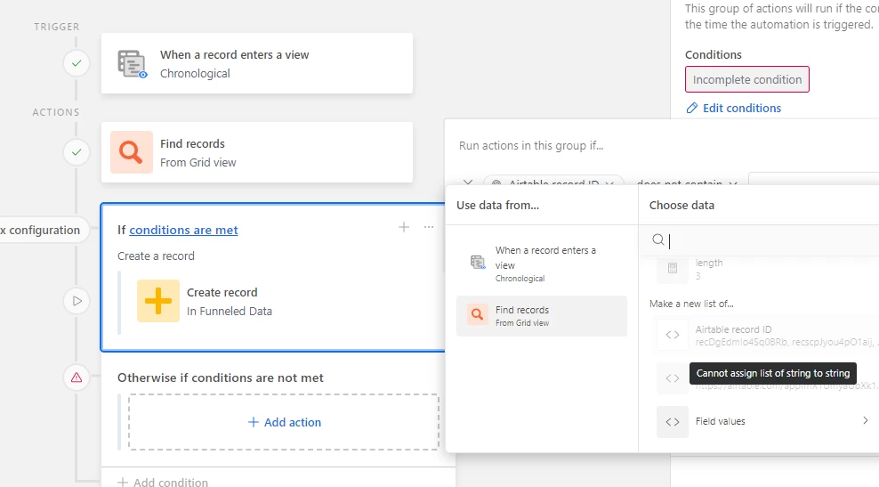

Been trying to update a table (Table C for our example) whenever Table A and Table B get information without duplicating pre-existing records. I am hoping that I am able to do so simply through the automations in Airtable but so far im stuck since all my attempts have led to errors because my condition cannot be applied.
The my current automation process looks like this:
Step 1, Trigger: Whenever a new record is added in Table A
Step 2: Finds the data in Table C
Step 3, If Condition: Airtable record ID  does not contain Airtable record ID
create record in Table C
I would have used the same process for getting the data in Table B to Table C. The issue here is that there is an error indicating that I "cannot assign list of string to string". Is there a workaround for this? Is there something I can edit or change just so I can get this automation working without the use of a 3rd party interface?

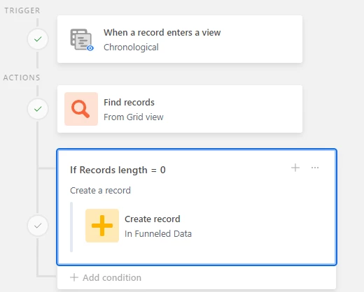

Hmm, how are you checking for duplicates in Table C?  Assuming you're using a unique ID such as email, you could use the condition of "Length = 0" instead, thus creating a record if no records were found.
Could you provide access to an example base with some data so that I could help further?

At the moment, there are no duplicates in Table C. It's more or less blank, there is data in Table A and B but they have duplicate records. I just tried using the condition "Length = 0" and nothing happed. There was no record transferred from Table A/B to C. I am new to Airtable which is hopefully obvious by now

Is your goal to get the person's "Number" and "Email" value from the "Contacts" table into the "Bookings" table?  If so, I would suggest looking into linked records and lookup fields, and specifically this guide by Airtable on linking existing records too

Among other things, yes. It should just be once since they would be new customers but what needs to be updated all the time in the funneled data table is the date of the most recent booking and the like (Arrival time).
Ah, so your goal is to get the latest "Arrival Time" value into the "Contacts" table?  If so, link the records together and then add a rollup field pointed at the "Arrival Time" field with a formula of "MAX(values)"
