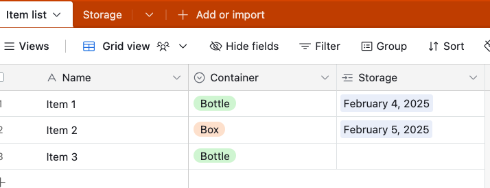

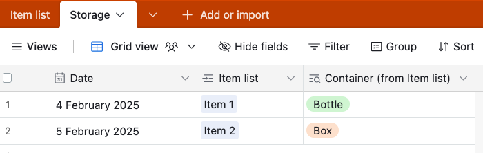

Yeap, a lookup field would be ideal for that
