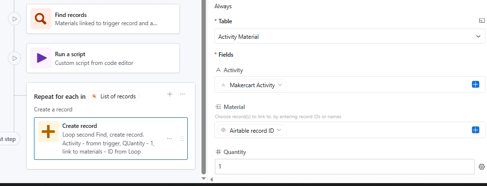

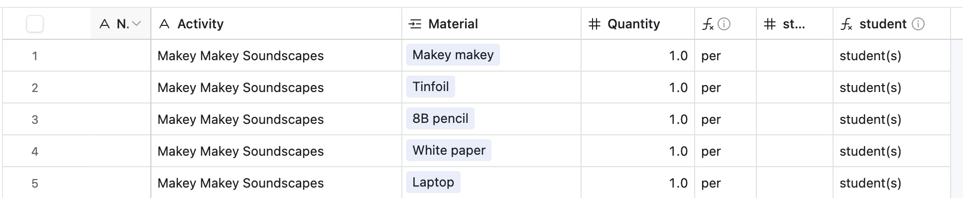

Well, it was interesting. I tried to add any trigger and did it from checkbox.
Since Msterials table linked to Junction, you need lookup from it. Activity (from Activity Material)
That’s all.
(Material N - trigger value of link field)
(record ID, Makecratd Activity - from trigger,  Activity (from Activity Material) - added lookup)
I suppose no need to break del operation to batches - 50 records at a time.
I think it’s good to add demo of test Results

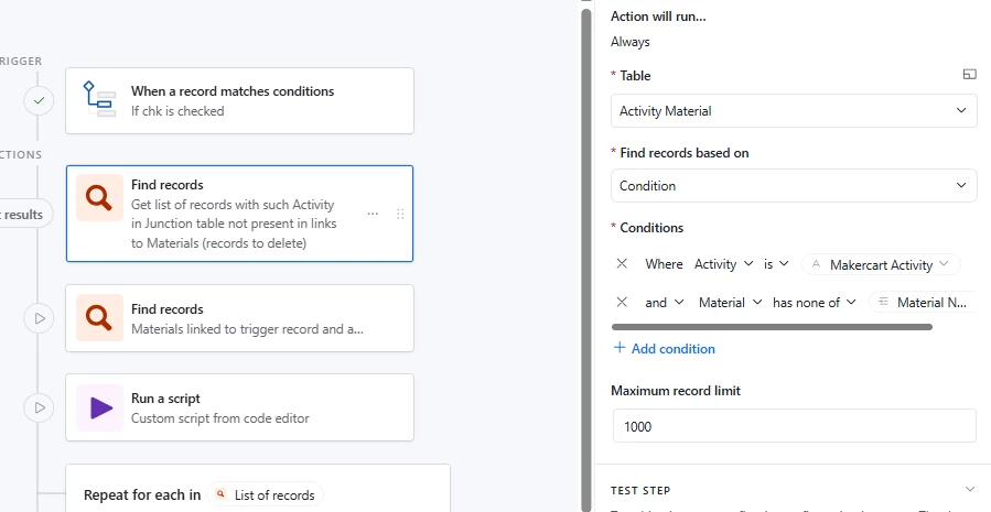

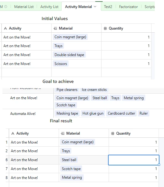

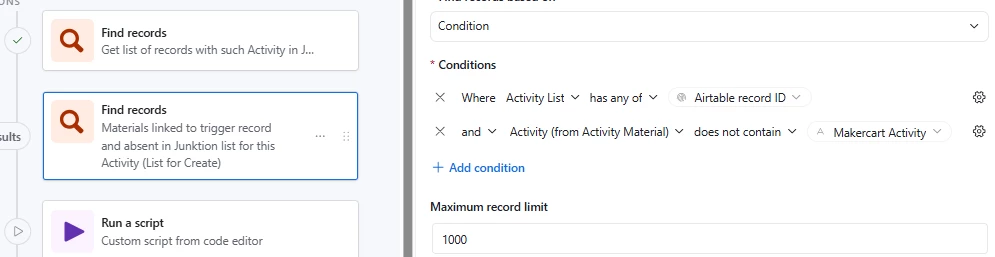

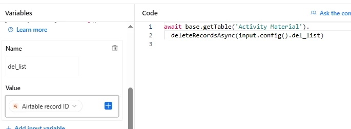

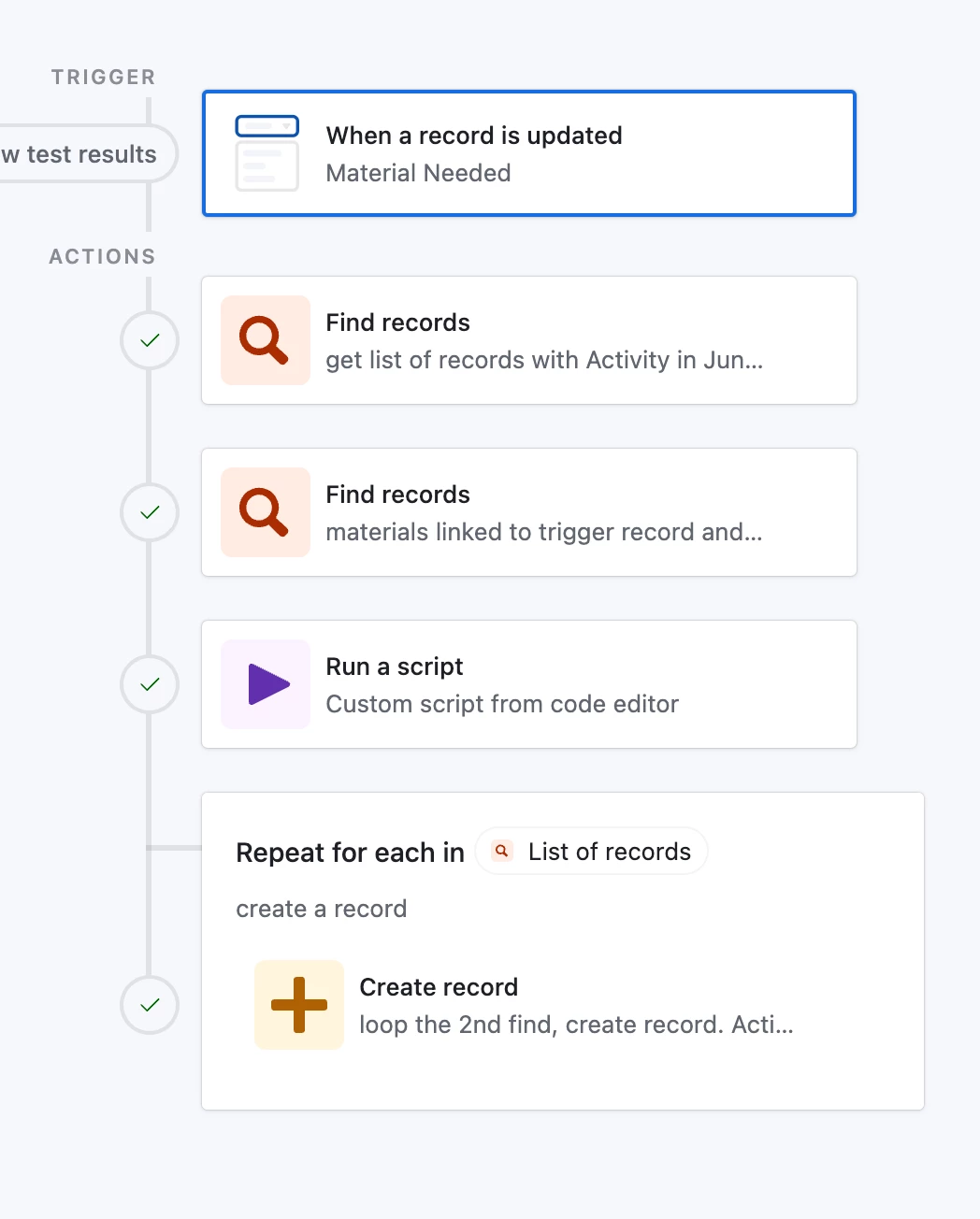

That’s all.

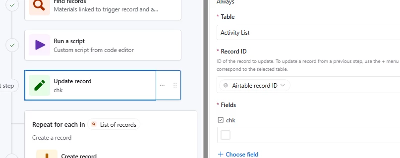

Btw, when using checkbox for trigger, after you set up and check that all OK, I would recommend to add easy and not mandatory step that make it looks ‘more automatic’. Usually I add it in the end, but since Repeating group not allows steps after it, it’s ok to set it before.
  • September 6, 2025
Alexey - your solution worked perfectly for me. BTW - I used a record-updated trigger, not a checkbox trigger in the end.
