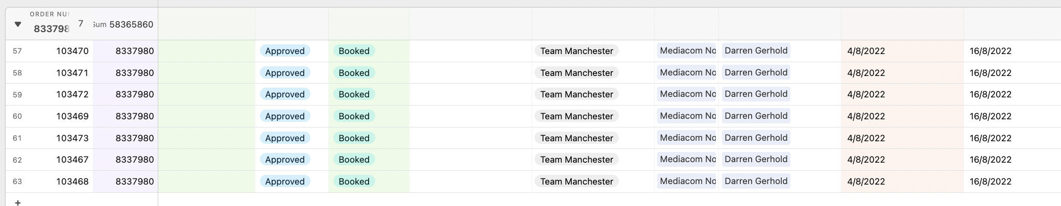

Example below, Campaign 8337980 has 7 flights going live on the same day so
it will send an automation 7 times when we only need it sent once.
The reason they are split out is because we use CSV Upload and we use the Flight ID as the Unique field, the campaign ref can be the same for a Flight.

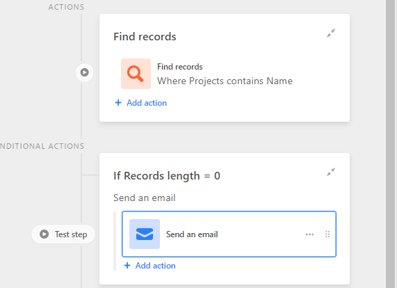

it’s quite easy.
before sending, add ‘Find records’ step to search for records with the same Campaign ref.
Make sending conditional - to run if Find Records list length = 0.

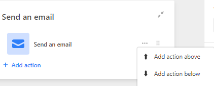

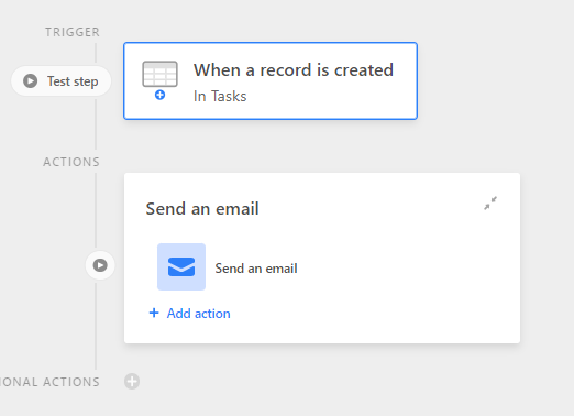

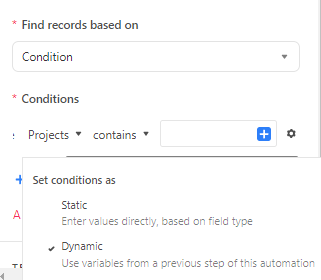

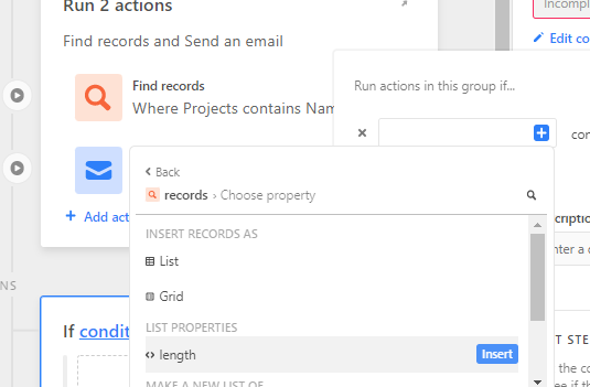

Currently, it should look like this
add step:
add condition
Grab your action using that icon
and move to the conditional:
(I’ve set any Find condition., just for example)
Thus, action will run only for the first record of a list
