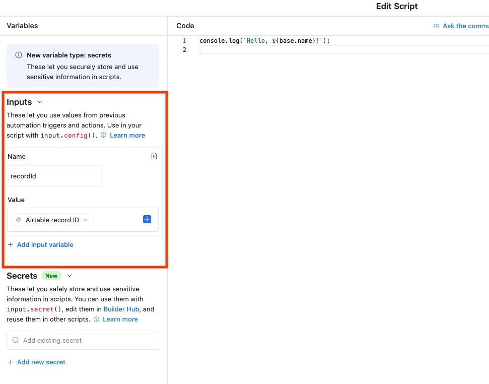

re: Going back and forth with CGPT it seems like the start and end dates are not getting passed correctly, but CGPT keeps telling me to “configure the script input variables” which doesn’t seem to be a thing in my airtable (Teams paid version).
Ah that’s a thing, it’s on the left here:
  • June 3, 2025
oh crap. You’re right. I never noticed that over there. I see it now. thank you so much!! Maybe with the variable input  screen revealed I can figure out how to make the former path I was going down work. Thank you - I’ll keep working at it.
