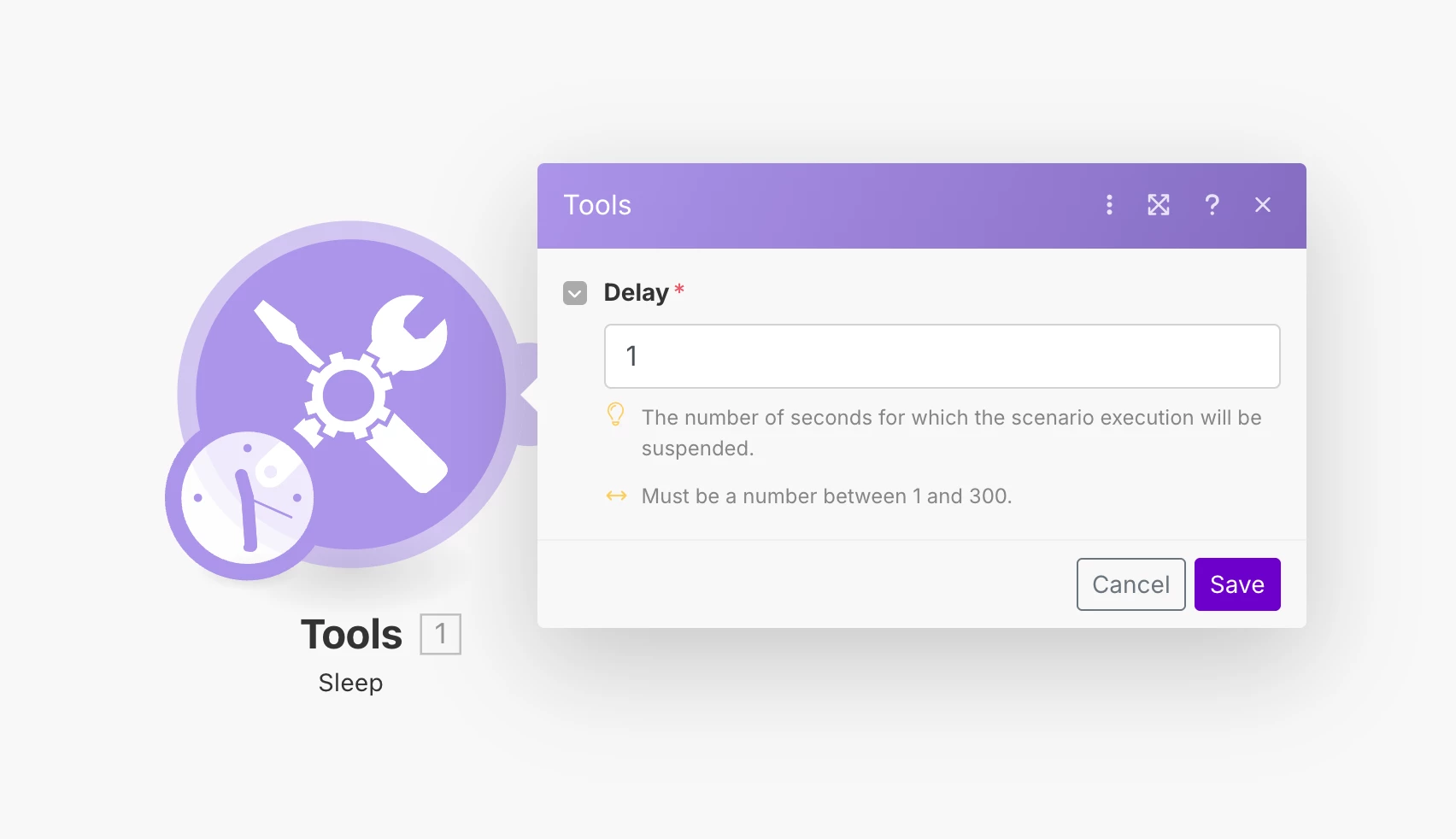

​@mflo  if you need to create that delay, you can use Make.com and use the module sleep to delay each run a couple of seconds.
But in this case you would need to move the automation outside or Airtable.

The simplest way would be to use a Make scenario where you’d turn on ‘Sequential processing’ I think.  Free plan has 1k ops, so you should be fine for 500 or so Documint calls?
