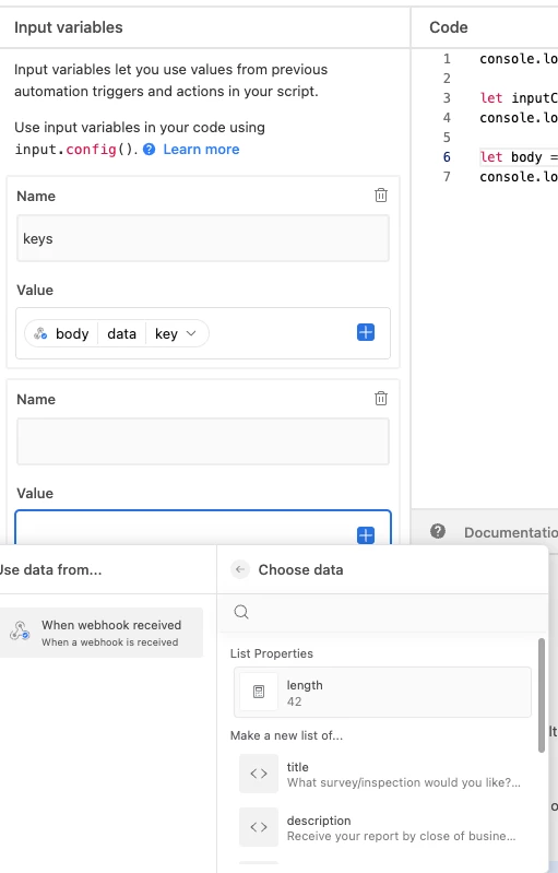

This means that the when trying to use the data in a script using inputConfig it wants to create a list of values e.g a list of all "custom_keys" or all "types"... not helpful. Moreover it can't actually create a list of the values for the key "value" as it says
"Cannot assign list of collection of complex types to collection of complex types"
Is there no way to simply get the full payload of a webhook as a variable for my script beyond using some external service to serialize it and then parse  in the script?

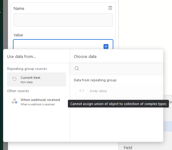

I thought I may have been able to help with this one, but then found the exact same limitation - we can't simply import the body as an object into a scripting action.
Then I thought, I might try out the recently released Repeating Group action to process your data as a list, but it again hits similar issues, as per the below screenshot.
This is worth raising as a feature request with Airtable, I dare say it must have been requested countless times already. I've always had the luxury of writing my own Post requests, so haven't hit this problem before.

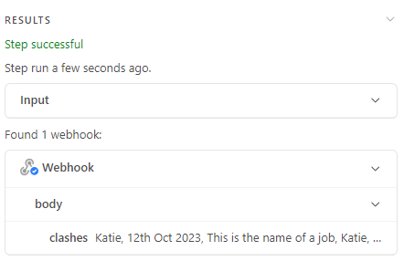

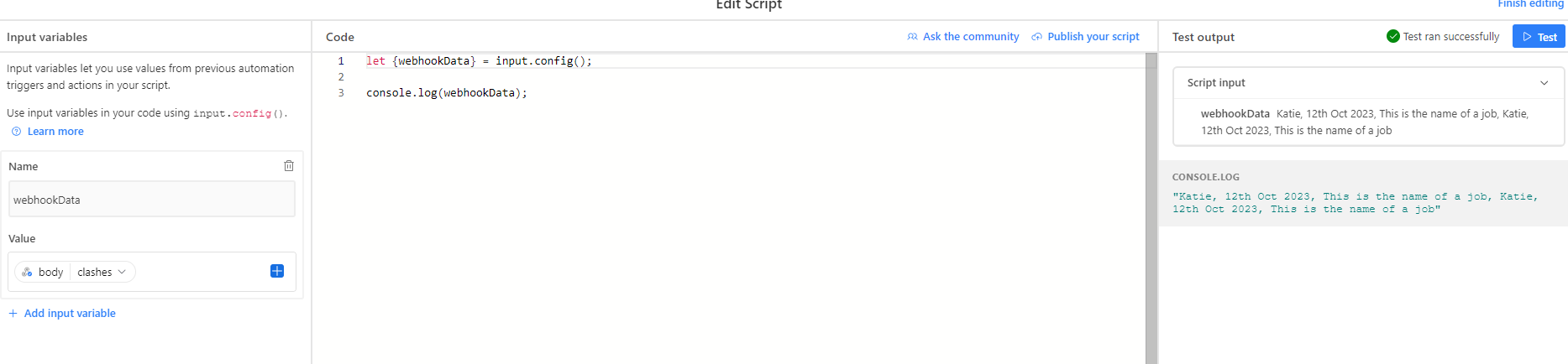

Hiya, not sure if my response is helpful, but thought I would share as I have also been trying to get around this, it's very annoying. In the end I just sent my data as a massive string and split it on the receiving side with a script.
Where previously my data for each clash looked the same as yours:
e.g.:
{ 'name': 'Katie', 'date': '12th Oct 2023', 'job': 'This is the name of a job' }, { 'name': 'Katie', 'date': '12th Oct 2023', 'job': 'This is the name of a job' }
I just concatenated it into a string like:
let clashes = "Katie, 12th Oct 2023, This is the name of a job, Katie, 12th Oct 2023, This is the name of a job"
and then sent it like this:
method: 'POST', body: JSON.stringify({"clashes": clashes}), headers: { 'Content-Type': 'application/json', },
Then you can access everything at once 😊
I will split by "," and deal with the array.
Not cleanest solution, but it's worked for me 🙂

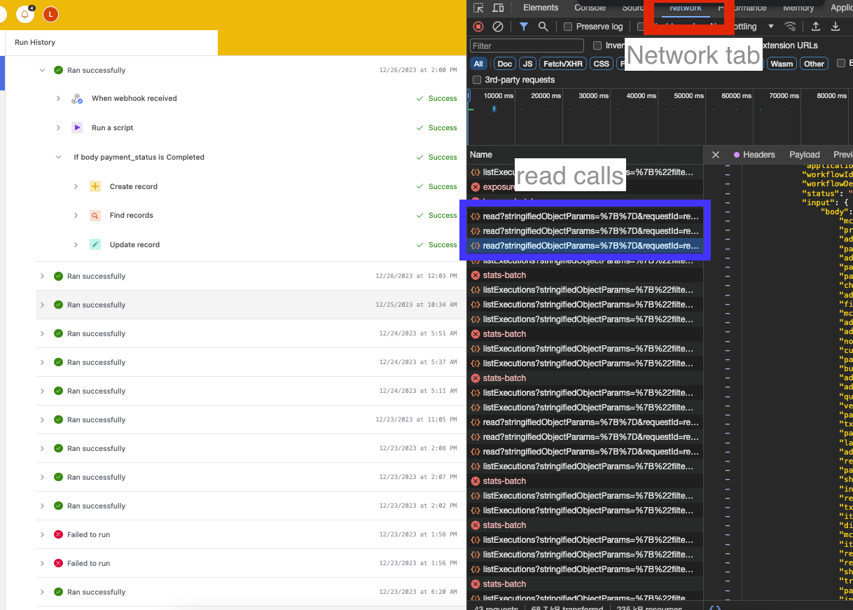

Something I've done in the past is go to "run history" and use developer tools > network tab to get JSON for the specific message. If you open up a specific automation call, you'll see calls to
https://airtable.com/v0.3/workflowExecution/{workflow_ID}/read?. .. labelled  in developer tools as read?..
The first two request (at least for me) are the test data used by the workflow. The last request actually contains the json blob of the incoming webhook call. Hope this helps

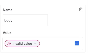

There is a way to “hack” Airtable to make this work. When you setup the automation with a webhook trigger, you build in based on the last test payload sent. So to set the entire payload body as the input to your script, first send a test webhook with the payload:
{“Body”: “”}
Airtable will think your data is a simple object, and you can just set that as your input to the script.
let body = input.config().body;
But once it receives the complete payload, you’ll get an error on the input. This script will still work! You just have to ignore that error.
