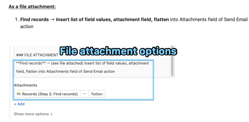

I’ve set something up for you here
The bit about adding the attachments always confuses me, so here’s a screenshot of the relevant part of the docs
