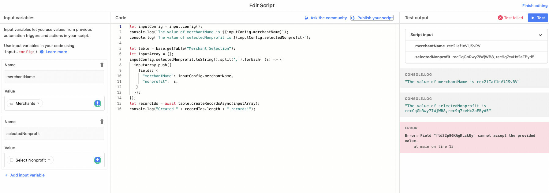

Thanks so much for this! Running into one more issue, we are trying to do a split of the Array and “split” is not a function in Airtable… any suggestions:
TypeError: rawInputs.selectedNonprofit.split is not a function
at main on line 4
let table = base.getTable("Merchant Selection");
let rawInputs = input.config();
let inputArray = [];
rawInputs['selectedNonprofit'].split(',').forEach( (s) => {
  inputArray.push({
    fields: {
      "merchantName": rawsInputs['merchantName'],
      "nonprofit":  s,
let recordIds = await table.createRecordsAsync(inputArray);
console.log("Created " + recordIds.length + " records!");```
at main on line 4
  inputArray.push({
    fields: {
      "nonprofit":  s,
![Screen Shot 2022-11-14 at 9.30.32 AM|700x255](upload://tqe242AiGGb4SVtbMZcFPBgZsvm.png)
Airtable scripting is javascript with some libraries so there definitely is a split function. I’m guessing the issue is that rawInputs['selectedNonprofit'] is not producting a String value and so whatever type it is doesn’t have a split function available.
Check the type of the token you are assigning to selectedNonprofit
If it isn’t a text type, then you might need explicitly cast the value to a string before you can split it.
rawInputs['selectedNonprofit'].toString().split(',').forEach( (s) => {

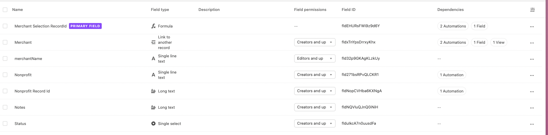

Thanks Nathaniel, now I’m running into a different issue:
I’ve updated the Value to be the record ID then extracted the record ID to be the linked record in the table but it’s not accepting the string for the record ID… any ideas?
Forum|alt.badge.img+13
Ah! I didn’t realize you were using a Link to Record field. I believe that the Link field is represented as an array already so you can just do the foreach on it directly and not need to split!
rawInputs['selectedNonprofit'].forEach( (s) => {
If that doesn’t solve the problem, what type of field is “nonprofit” in the “Merchant Selection” table?
  • November 16, 2022
@Nathaniel_Granor solved! Thank you!
