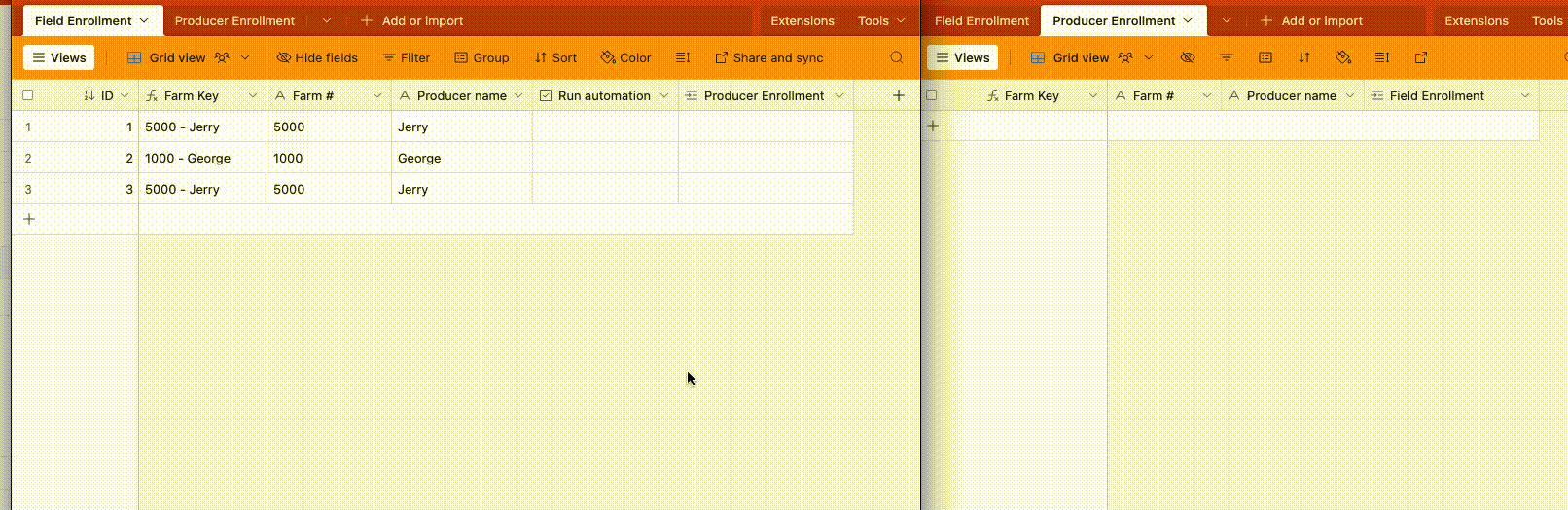

HI there - I’m about to pull my hair out and have been trying to figure this automation out for several hours now.

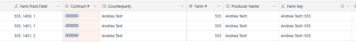

I have a table called “Field Enrollment” where I am tracking “Producers” with their unique farm #, tract #, and field #. I have a concatenate formula to give me “Farm Key” which is Producer & Farm.
I have a second table called “Producer Enrollment” that I want to be auto populated by the Farm Key. However, there are cases like in my example where there are duplicate Farm Keys and I only want the one. (A bit more context: In Field Enrollment we are required to track data related to the unique Farm/Tract/Field. In Producer Enrollment, we are required to track other types of data related to the TOTAL farm, so essentially a roll -up from Field Enrollment.) How do I create the unique record?!
Example Field Enrollment table:
Example Producer Enrollment table:

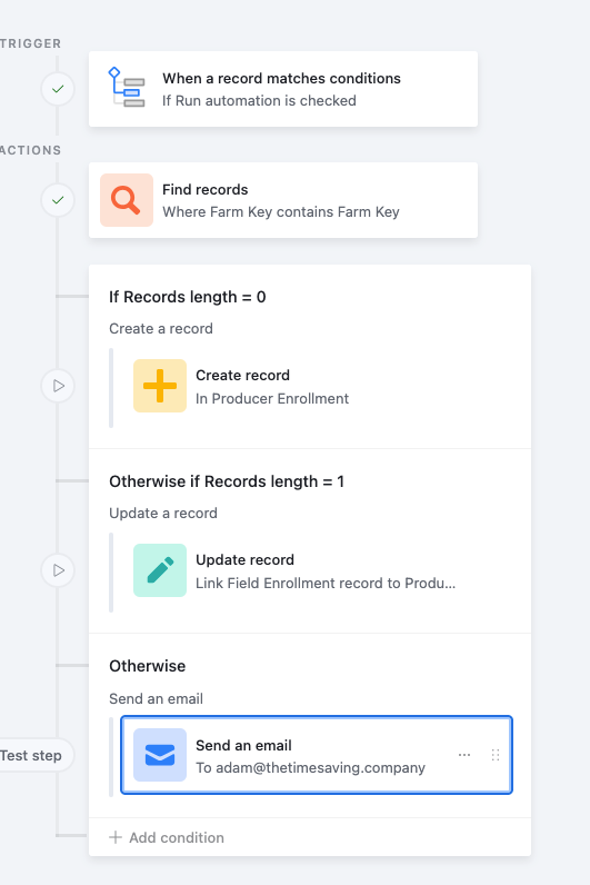

Here’s the automation I thought would work and is saying is working (but it’s not)
Hm, does this look right?
If so, I’ve set it up here for you to check out
And this is how the automation looks:
The idea is it’ll check many records it found, and if it didn’t find anything it’ll create one (records length = 0), and if it did it’ll link them together (records length = 1)
I also added a thing at the end where, if it found > 1 record (i.e. there’s more than one ‘Producer Enrollment’ record with the same farm key), then it’ll send an email alert

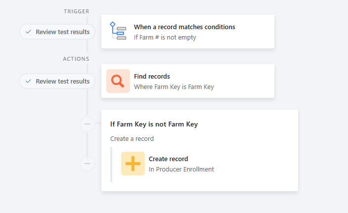

Hi Adam, wow! That’s looking pretty good! The only thing is that we have hundreds of these so I don’t want to click a “run automation” button. Is there some other trigger that could be used, perhaps “if Farm isn’t empty”? Will test now and report back. THANK YOU!!!
AndreaR
Forum|alt.badge.img+9
  • Apr 28, 2025 1:15 PM UTC
Oh lawd, it worked. THANK YOU. That only took me about 6 hours 😜 Have a good one!
