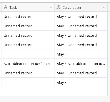

Hi @Allison_W ,
There are a few things you can do to get the desired result. A simple approach would be to create a formula that grabs the task creation date, converts it to Month, and ties it together with the task name.
Try this formula
DATETIME_FORMAT(CREATED_TIME(),'MMMM')&' - '&{Task}
Where the {Task} should be replaced with the name of the field that contains the Task Name.
  • May 23, 2022
I will try this, thank you! I would then need to create a new column for that formula and use that as the name of the task rather than the current name of the task. Am I understanding that correctly?
Forum|alt.badge.img+16
  • May 23, 2022
Yes, that should work.
  • May 24, 2022
That worked. Thank you!!
