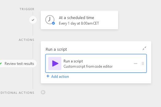

i will be as spesific as i can with the intention and infomation i'm gathering:
At a scheduled time, every day at 8am, i will run a script.

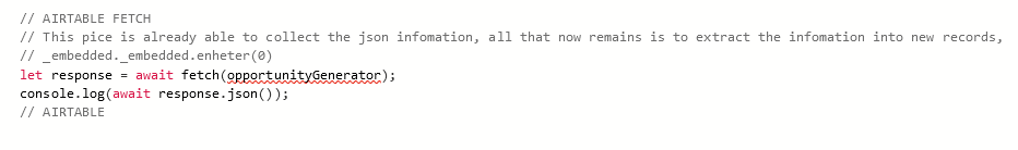

This script below here fetches the JSON i need. (example: https://data.brreg.no/enhetsregisteret/api/enheter?)

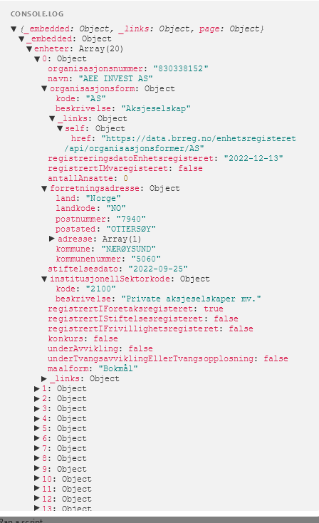

This is the output of the console.log so i know it works:
As you see, each object under the "enheter" array represents a company.
I want the automation to create records based on each object and fill it with the infomation given there.

Fixed it, looking through some documentation i figured out that each record field is declared as a item. All then that remained was to make a for loop counting the number of objects that arrived and push the looped value to the field value declared by Airtable in the background.

for (let i = 0; i < brregJson._embedded.enheter.length; i++) {
let organizationName = brregJson._embedded.enheter[i].navn
let organizationNumber = brregJson._embedded.enheter[i].organisasjonsnummer
let organizationType = brregJson._embedded.enheter[i].organisasjonsform.kode
console.log(brregJson._embedded.enheter[i]);
