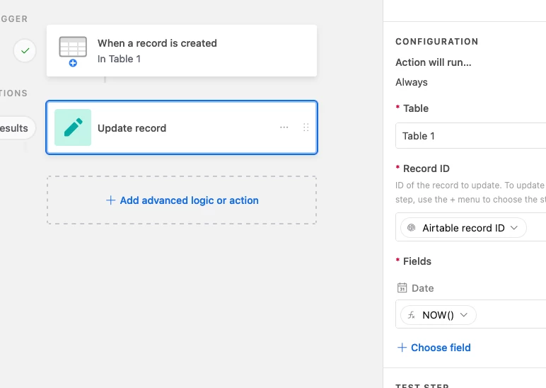

Ruchika_Abbi1
I want to set a Date field to the current date time in an automation. I tried using a formula field (with NOW()) from a previous step in the automation to set this Date field but the automation fails with the error;
Field "Date" cannot accept the provided value: Could not convert string to date.
No amount of formatting of the formula field is helping.

Hmm, weird.  Could you provide screenshots of your table and automation setup, or access to an example base where you're encountering this issue?
I was able to use an automation to paste the value from a formula field with "NOW()" into a Date field without that error and so I think my setup's different from yours:
Link to base
