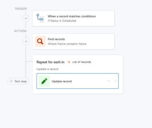

  2. If you want Deliverables’ status to actually update, set up an automation:
    a. Trigger it when a Project’s status changes to “Archived.”
    b. Find all Deliverables linked to that Project.
    c. Loop through those Deliverables and update their status to “Archived.”
attached screenshot for your reference.
Let me know if you need more help. If this works, please mark it as solved. 😊
