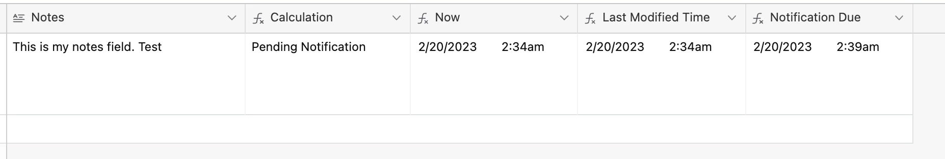

In this first screenshot, you can see the current value of NOW(). You can also see that the time of my last edit is identical to the value of NOW().
In this example, I have the waiting period set to be five minutes after the last modified time. This value is reflected in the Notification Due field.

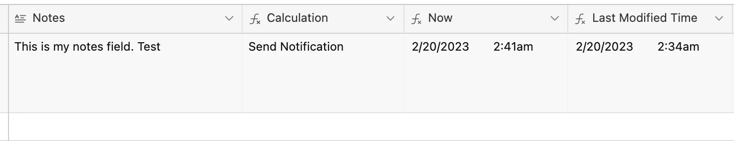

Here's what happens once the waiting period has lapsed and the current time is now after that calculated waiting period.
Here's the formula I used for this example:
IF( LAST_MODIFIED_TIME(), IF( NOW() >= DATEADD(LAST_MODIFIED_TIME(), "5", "minutes"), "Send Notification", "Pending Notification" ) )
