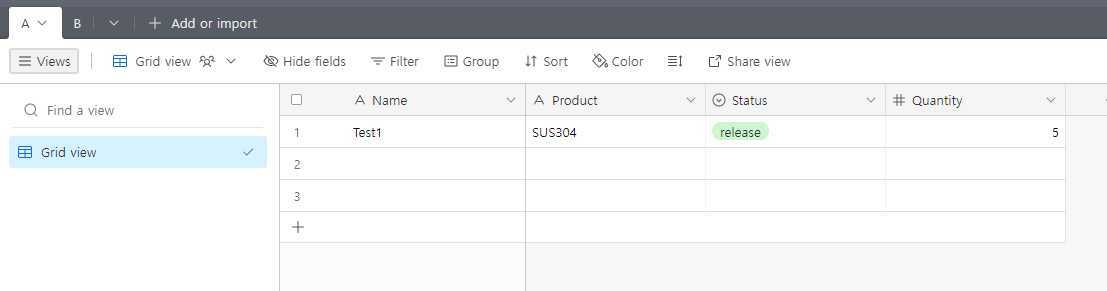

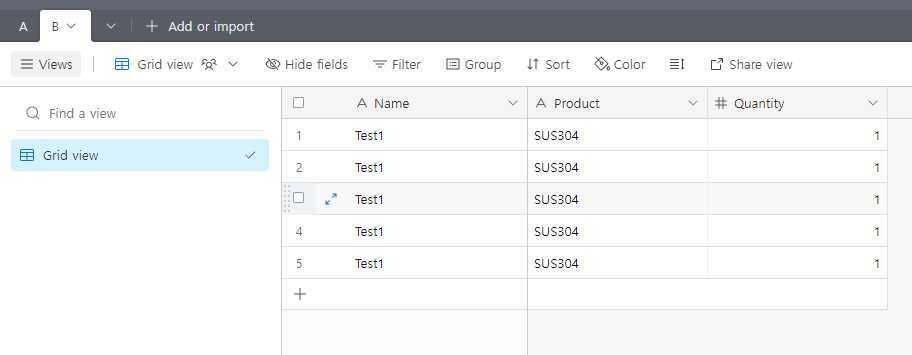

Hello, I'd like to know how to create new records using automaitons in B table as many as the quantity of number column(ex. 5) in A table when the status column in A table has a specific value(ex. realease).
See the example below.
1. Input
2. Output
I'd appreciate it if you could let me know.
