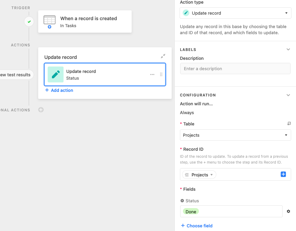

If the task is linked to the project, you could make an automation that triggers when that task type is checked off, and its action would be to update the project's checkbox field

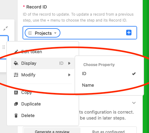

You'll need to swap out the "Display as" portion so that it'll work:
If the task isn't linked to the project...well, I assume you've got some sort of identifier for each task that indicates which project it's for?  You could then use that in a "Find Records" action, followed by an "Update Record" action
