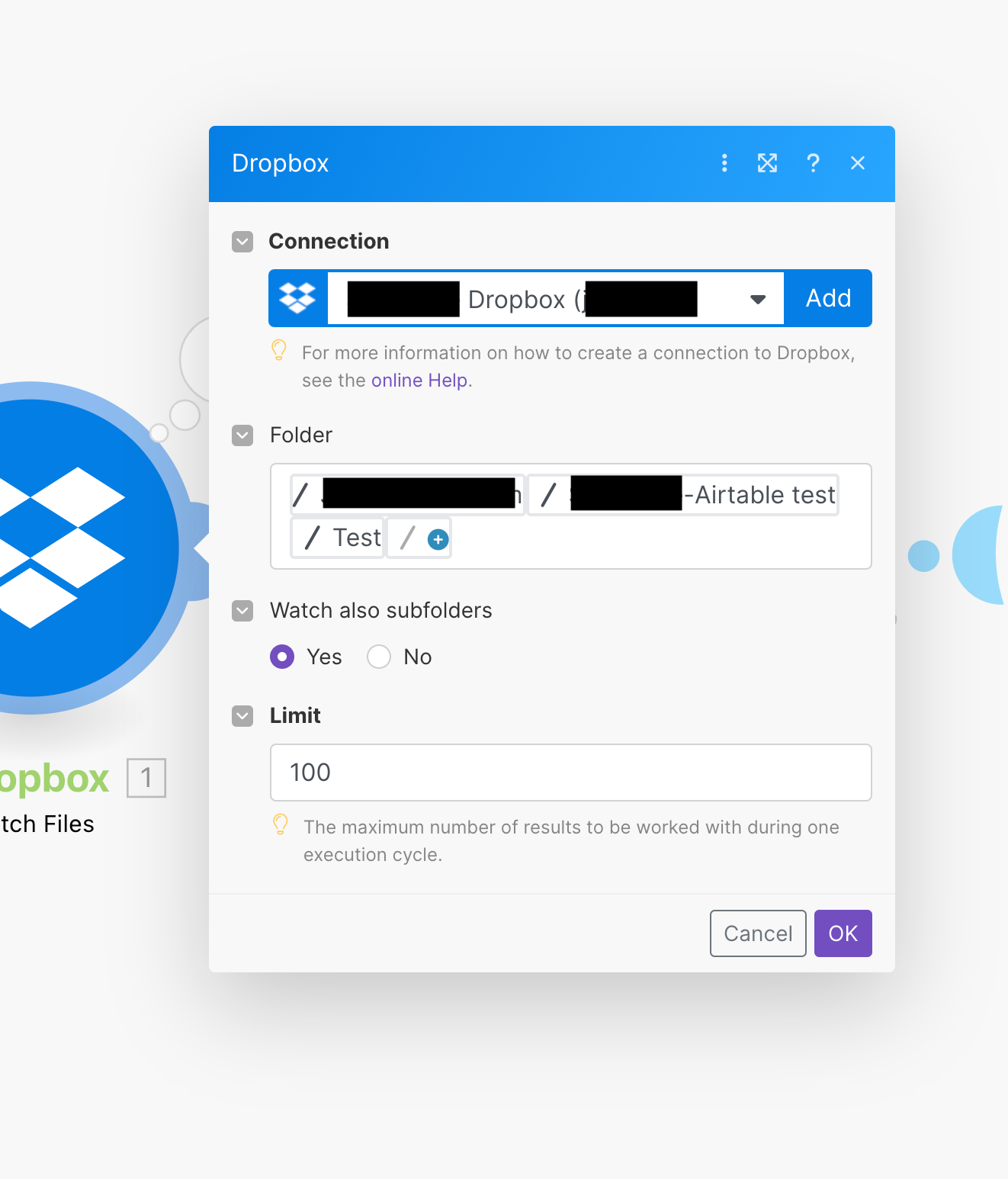

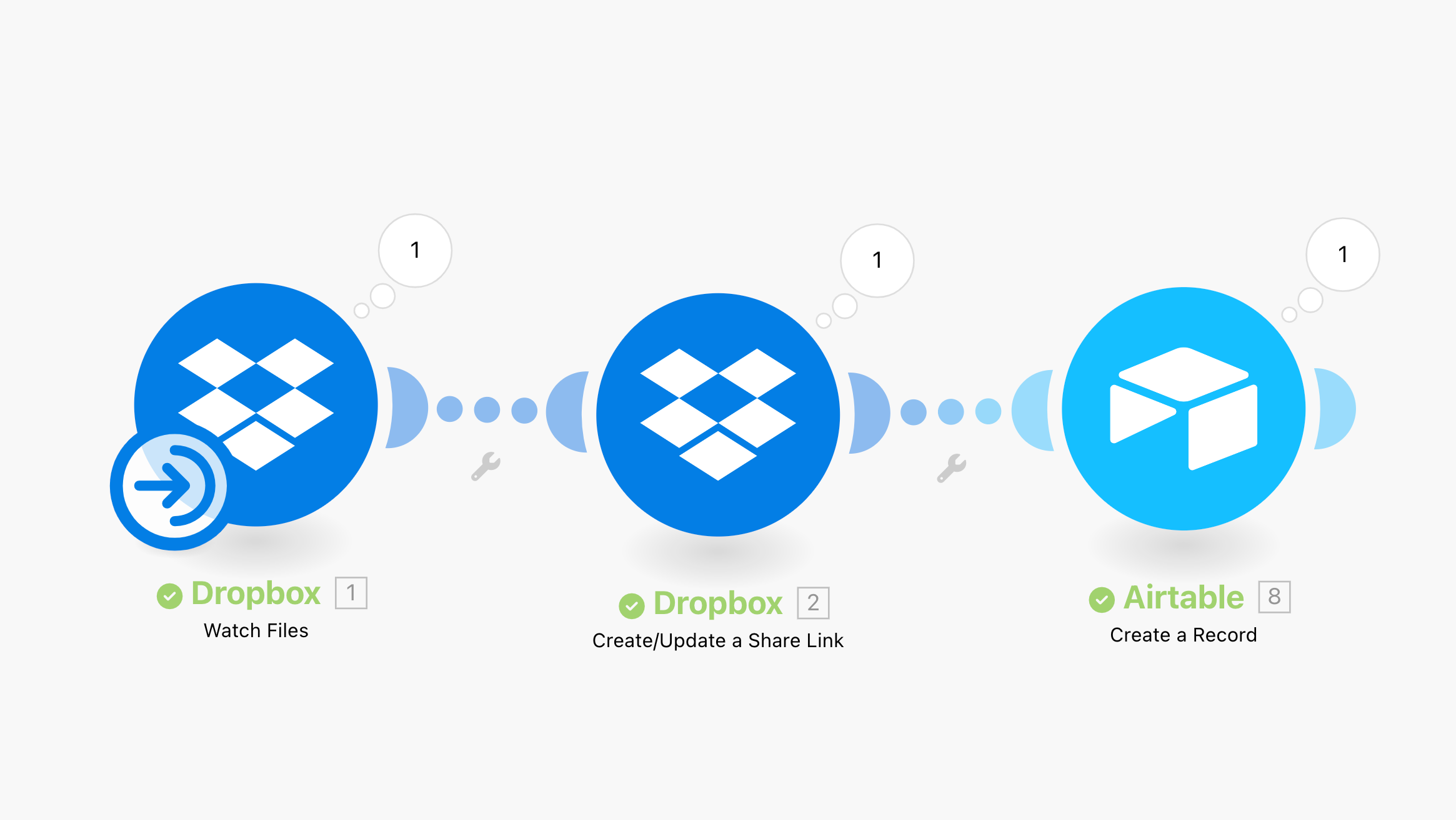

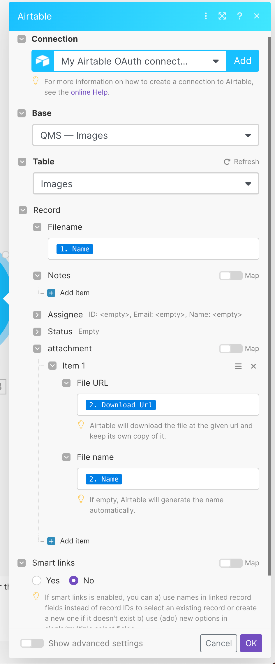

I am trying to automate the following process: when a file is uploaded to a specific Dropbox folder, a new record is created in Airtable with the file attached. This works fine, but there is no preview in Airtable. I have created the following automation in Make (formerly Integromat):

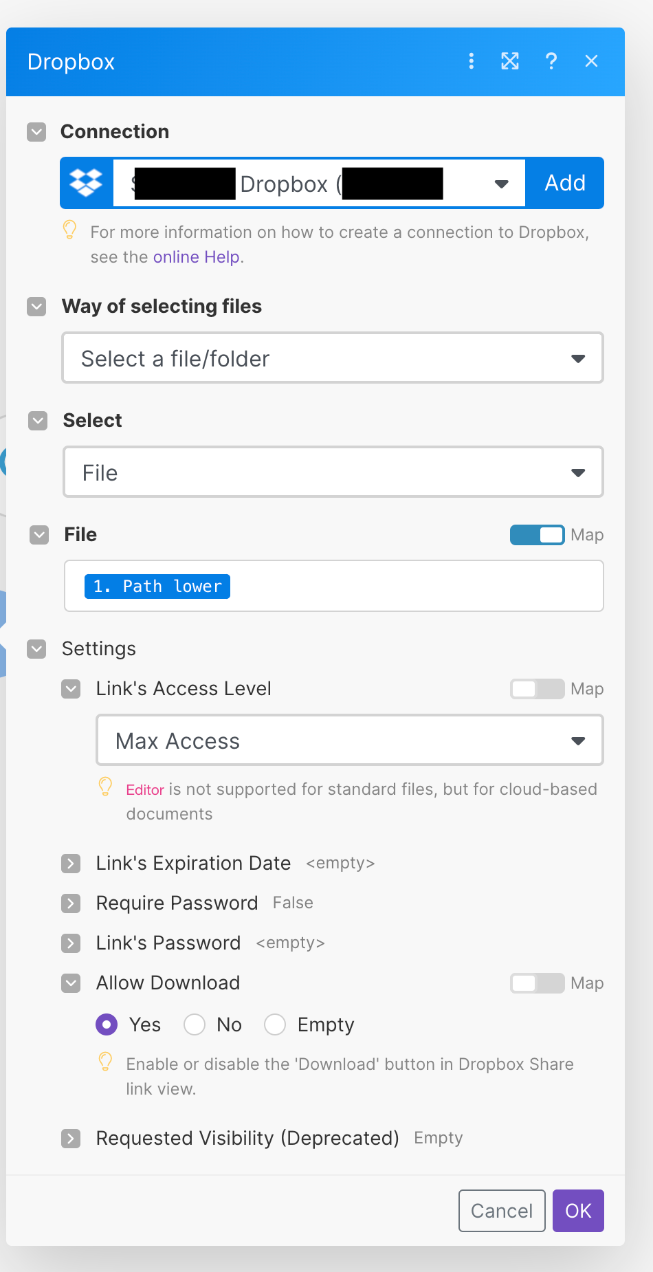

Here are the details of each step:  

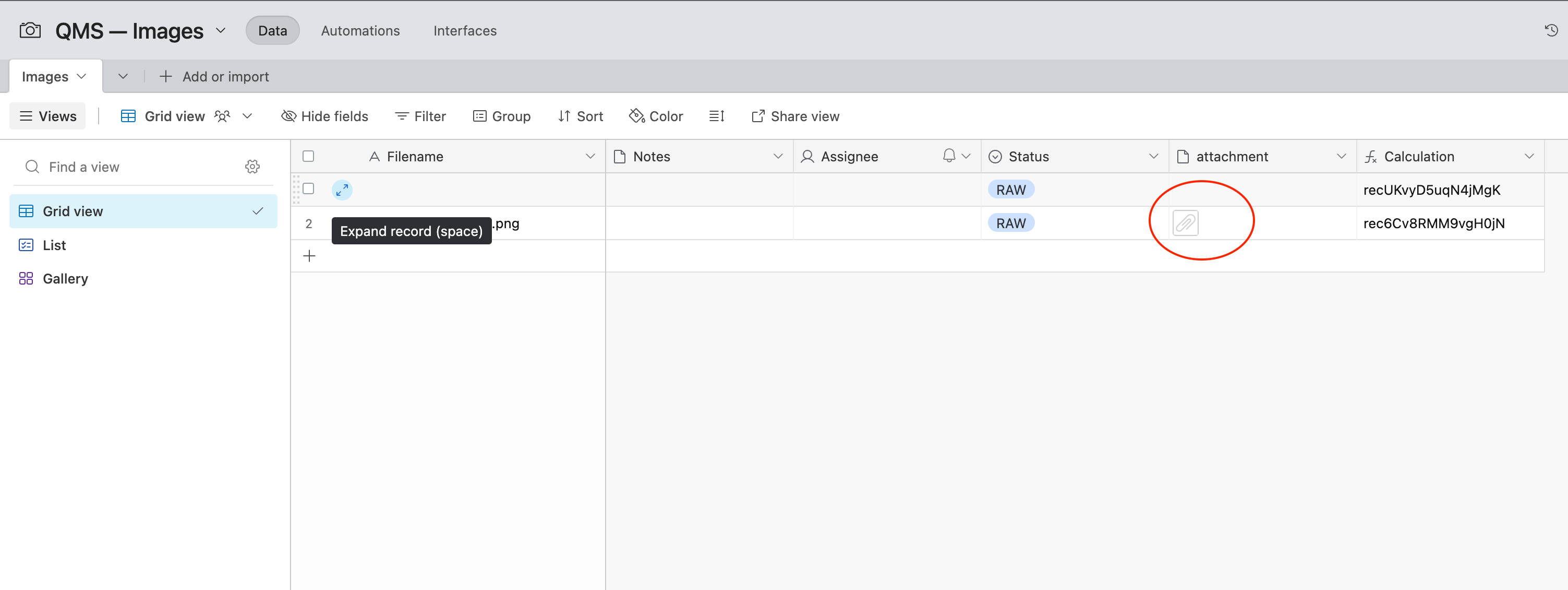

Below is what is seen in Airtable. As you can see, no preview is shown.

The error message I see is: "Previews for this filetype are not available".

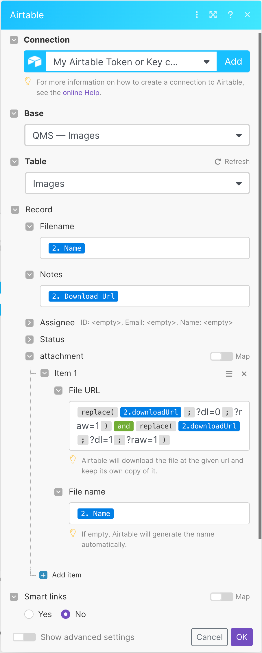

I added the following to the automation:
The following function fix the issue; now image previews are displayed:
replace(2.downloadURL;?dl=0;?raw=1)and replace(2.downloadURL;?dl=1;?raw=1).
