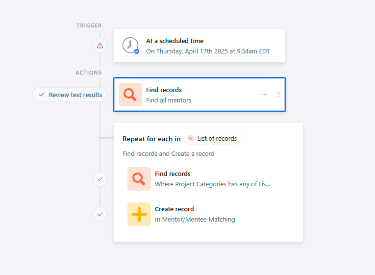

I had this setup but can’t figure out how to get it to make each match its own row. Here was the automation I setup:
The automation would go through every entry in the Mentor table, find all matches in the Mentee table, and then attach all possible Mentees to one entry in the match table. So it would output these matches:
  • Mentor A + Mentee A Mentee B Mentee D
  • Mentor B + Mentee A Mentee D Mentee H

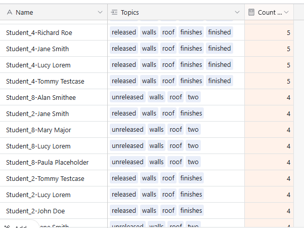

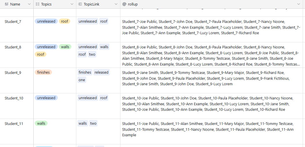

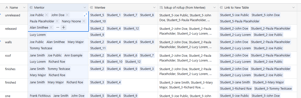

You can have less beautiful but more functional base and easily achieve your goal, if you create the table of Topics and use links to it instead of multiselect.In my example I just duplicated multiselect and turned into linked field
Table of Topics will have links to both fields, so you can add Rollup of Mentors in the table of Mentees
in a following way: (ignore topic values, I just took anything existing in my test base)
Rollup formula
Name&'-'&SUBSTITUTE(ARRAYJOIN(values,', '), ', ' , ', '&Name&'-')

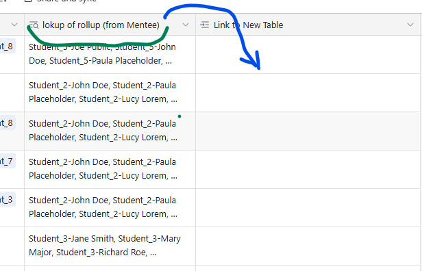

But the main advantage that if you create lookup of this rollup field in ‘Topics’ and copy it
to a new linked field (to a new table)
you will get junction table of pairs with a number of common topics (and their list)
Most of this config will be up to date, according to current Mentees and Mentors table

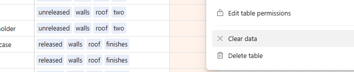

To refresh, you just need:
Clear data of new table(removes all records)
Copy lookup to Link field in Topics table:  select field, ctrl+C, Ctrl+V
