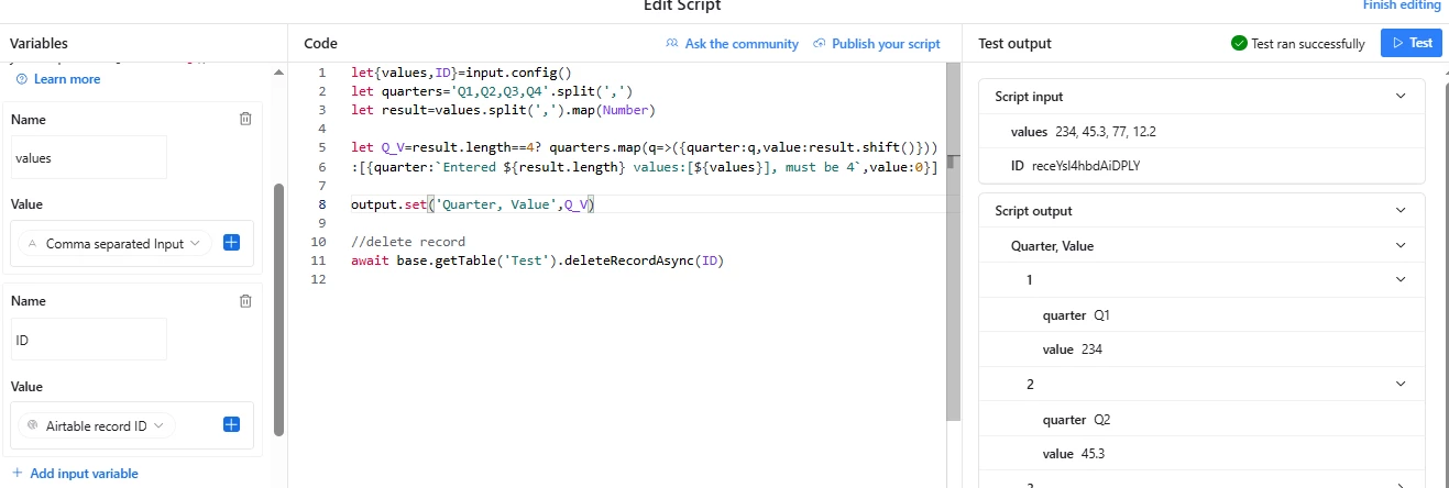

Hi

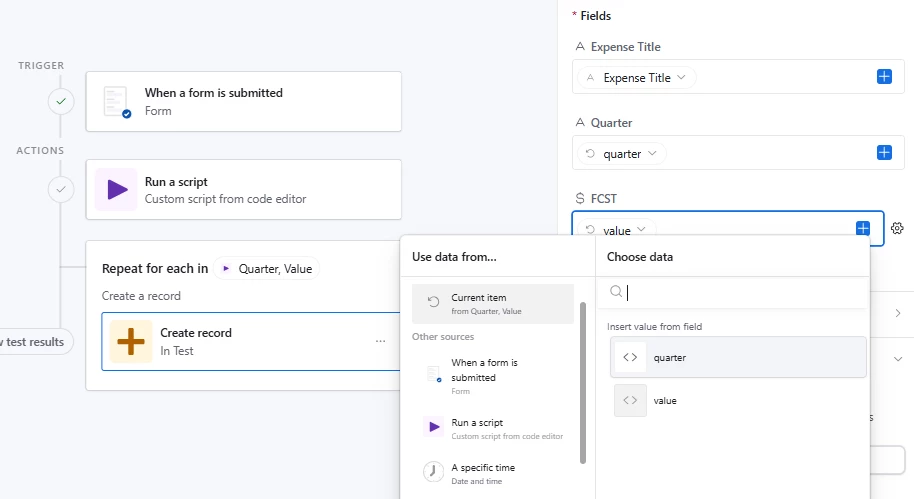

You can use automation to reach your goal
Currency field can’t hold several multiple values, so you should add text field for that (hidden, if you want). Then add form to enter Title and values, add script step and use script output to populate
loop with 4 create Create record steps

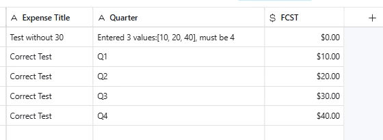

script can be ‘more simple’, 2-3 lines, but in my experience, there is always a place for human error. So it would be good to check that exactly 4 values entered.
That’s script steps
Don’t forget to fill left part variables: values. ID
Code text to paste
let {values,ID}=input.config()
let quarters='Q1,Q2,Q3,Q4'.split(',')
let result=values.split(',').map(Number)
let Q_V=result.length==4? quarters.map(q=>({quarter:q,value:result.shift()}))
:[{quarter:`Entered ${result.length} values:[${values}], must be 4`,value:0}]
output.set('Quarter, Value',Q_V)
//delete record
await base.getTable('Test').deleteRecordAsync(ID)
You can omit delete record if needed. Or change quarters format.
