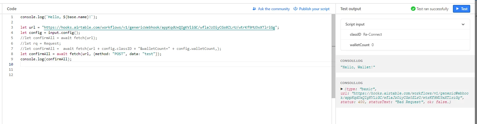

The result is the error in the screenshot below.
This raises the obvious two-part question: Why is the console message indicating that the URL is not found and the automation test failing as a result?

Yes, after doing a few variations and bringing it down to the most basic request structure, it’s sending a 400 status (bad request), versus 404 - Not Found. See below

Pasted the wrong reply capture - refer to this one instead

You need to have your post body in JSON format and have a header that says your content is in JSON format.
You also need to convert the response into readable text.
Here is more documentation about fetch.

This is what you should do:
if you’re passing data as JSON, you should call:
const url = "https://hooks.airtable.com/workflows/v1/genericWebhook/urlxyz";
let options = {
    method: "POST",
    headers: { 'Content-Type': 'application/json' },
    body: JSON.stringify({test: false})
const res = await fetch(url, options);
And if you want to pass data as parameters:
const url = "https://hooks.airtable.com/workflows/v1/genericWebhook/urlxyz?data=abc";
let options = {
    method: "POST",
    headers: { 'Content-Type': 'application/x-www-form-urlencoded' },
