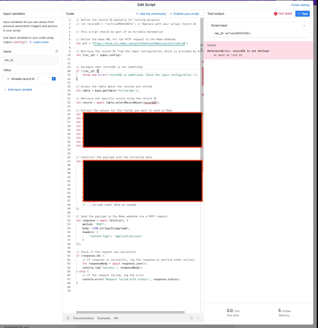

It's been several months since I've done this, but basically, I'm trying to send an automation from a clicked button in an AT interface to a Make webhook that I've created.
The automation so far was when a button is clicked > run a script. I've been able to successfully pull in a test record id via the "when a button is clicked" stage -- my field is named "rec_id" with the autogenerated formula and that works fine.
FYI--when I hardcode the rec_id in there with the actual value, it works just fine with significantly less code. But with the code below--whenever I get to this step below, it just doesn't work. Can anyone help? Thanks!
let recordID = input.config().rec_id;
// Validate that recordID is not undefined
if (!recordID) {
    throw new Error('recordID is undefined. Check the input configuration.');
THE WHOLE CODE

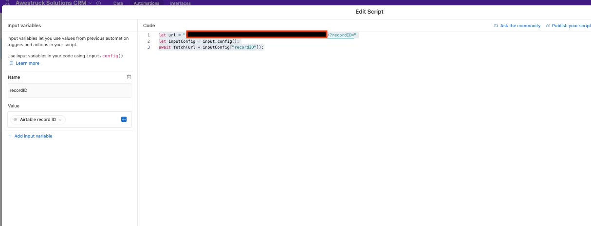

So a friend showed me:
let url = "my-web-hook/?recordID="
let inputConfig = input.config();
await fetch(url + inputConfig["recordID"]);
and that worked. .

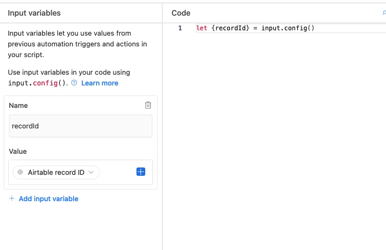

It seems like your input config's not set up properly, try setting it up like this instead:
So I believe I've tried this in two ways and I'm still having challenges. Do you have any thoughts?
Thanks!
Thanks!
The default response format from a Make webhook isn't JSON, and so attempting to parse the response as JSON using .json()'s causing that error.  Try removing line 63 and just console logging 'response' instead.  (This assumes you didn't create a webhook response module in your scenario)
The Make scenario runs fine even though your Airtable automation errors though right?
and that worked. .
