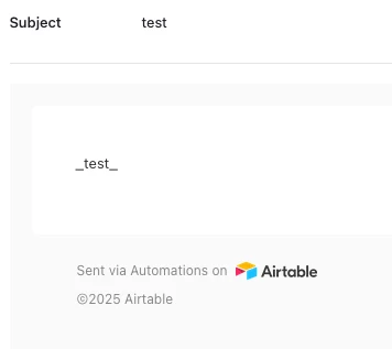

Try escaping them with a \?  e.g. this is my text:
And this is what the email looks like:
And the formula is:
SUBSTITUTE(
Name,
'_',
'\\_'

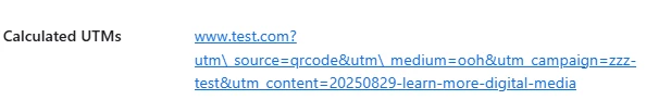

The problem seems to be that I can either have this formatted for the Interface or for Email. When I add backslashes or asterisks, they show up in the interface
Clunky, but what if you had one field for the email text and one field for the Interface display?
