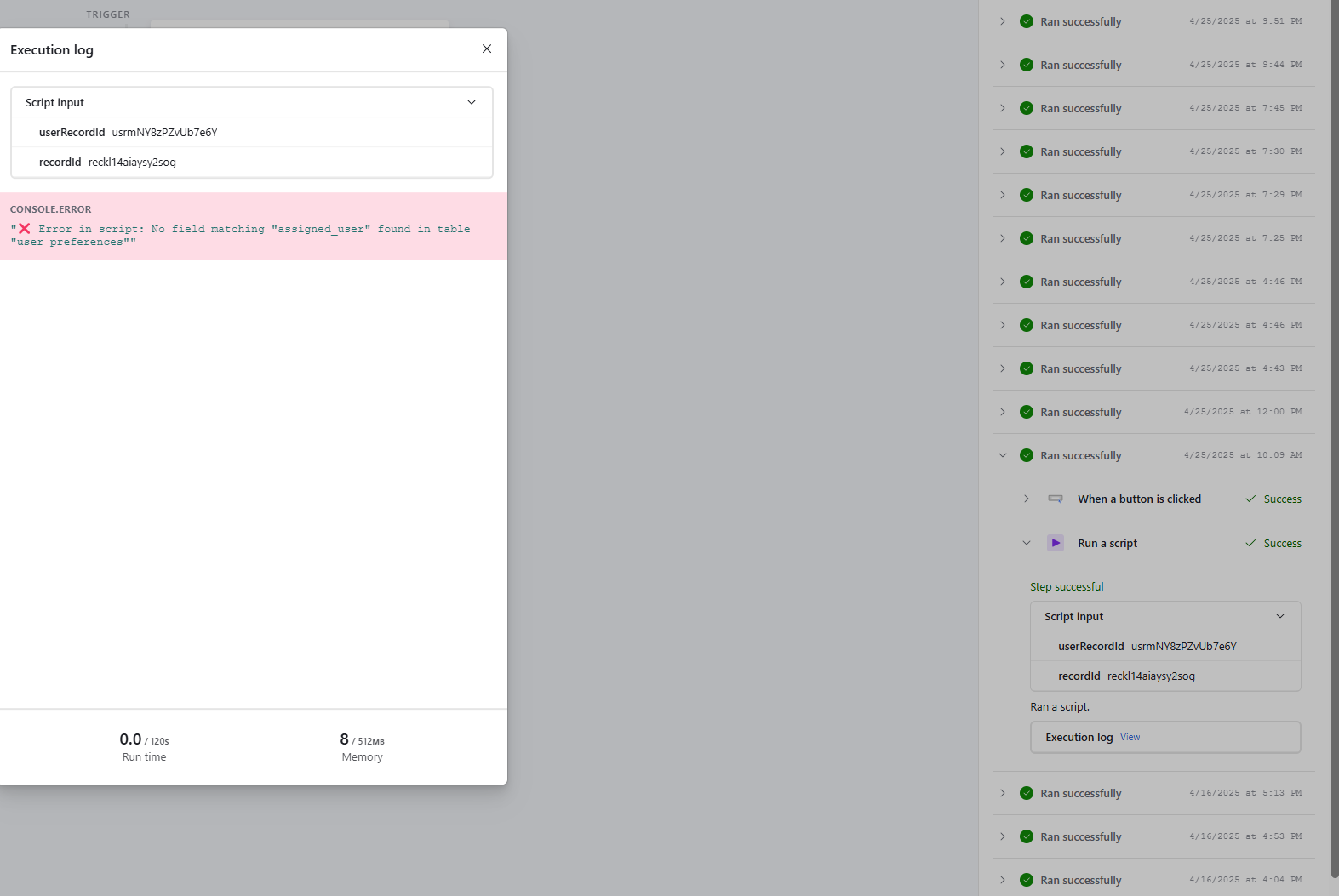

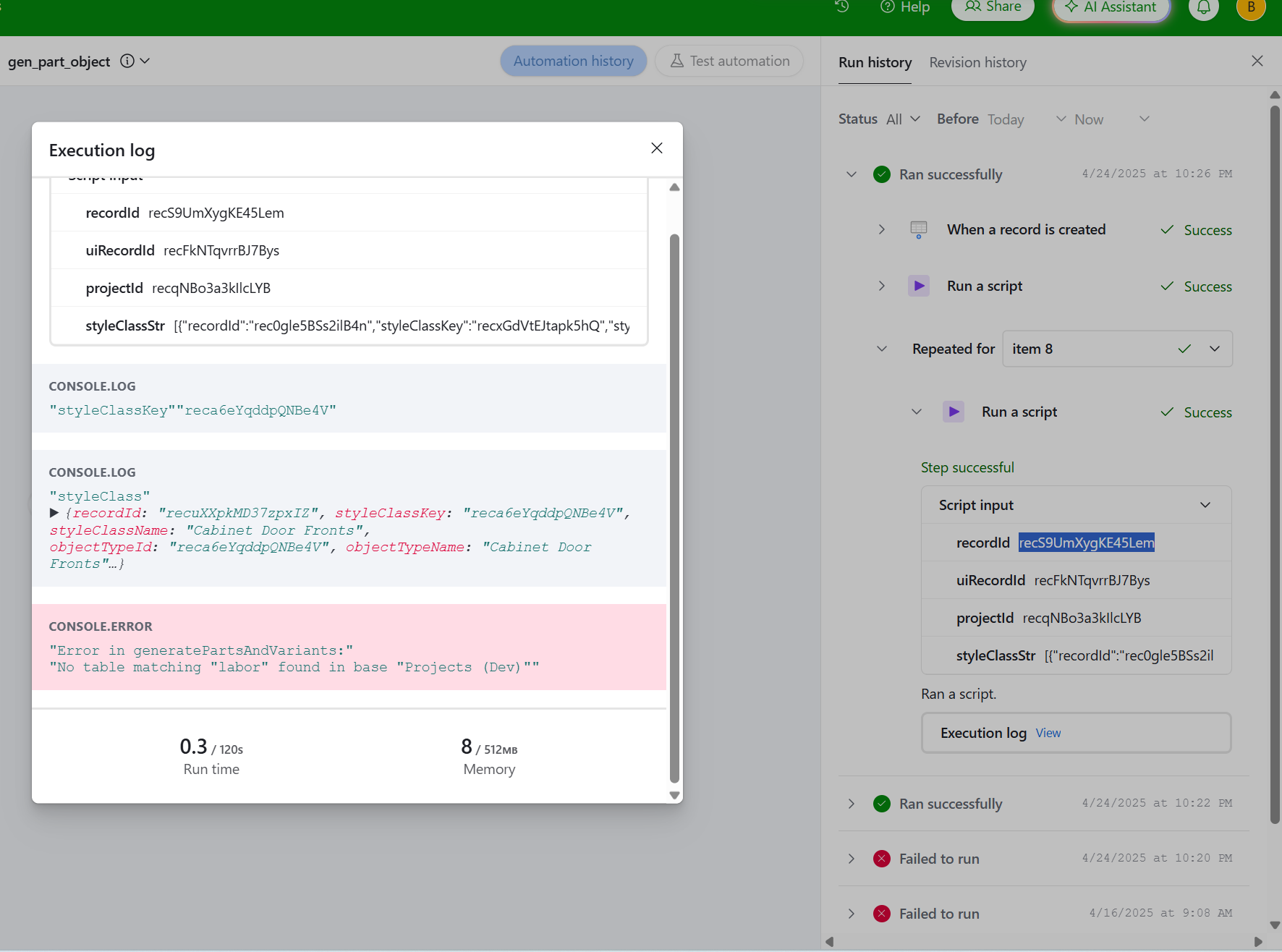

I have a script that is using a repeating group to batch process a couple of records sent through output.set() If one of the scripts fails it doesn’t seem to register that error in the overall automation. See image below, individual script failed, overall automation is giving me the green light. I noticed that the script wasn’t behaving correctly on some records but having the script not throw errors is potentially dangerous as problems stay hidden.

 The repeating group code is too big to paste here but I have the code below which is also not thowing an error even though I am throwing an error. Sometimes I’m wrapping my code in a seperate function so code in nested try catch blocks are being caught.
As you can see in the image its giving me the thumbs up but there is an issue that needs to be addressed and the script is thowing a console.error

} catch (error) {
console.error(`❌ Error in script: ${error.message}`);
Could you try adding a ‘throw’ after the ‘console.error’?
