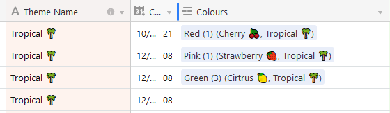

I’m parsing records with a matching string Name field - in this example “Tropical :palm_tree: ”. Then, from each returned record, I’m then filtering out any records where “myLinkedField” field is null.
From the four records found, we return the three with Colours.
What I’m now trying to achieve is to grab the array of linked “Colours” Record Ids found in the remaining filtered records (3 in total) - which I can do, but not in the desired return structure.
My filter/map code returns the correct data, but I’m needing help to massage it into a simple array that I can then use to stamp into the original record after deleting the duplicates.

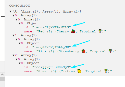

console.log(duplicateRecordsId)
Console Log looks good, but as you can see - the id object data I’m trying to access is buried. Example below;

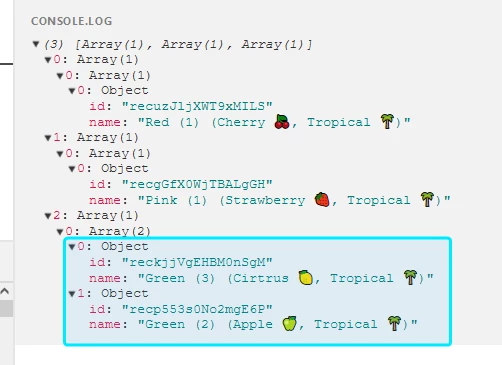

Worth noting that some Objects may contain multiple id’s themselves - for example;
So I’m needing to understand our options for mutating this return so that I may build an array such as;
['recuzJljXWT9xMILS', 'recgGfX0WjTBALgGH', 'reckjjVgEHBM0nSgM']

First off, you’ve created a nested array with this part of of your current code:
record => [record.getCellValue("Colours")]);
The square braces around the value retrieval create a literal array, meaning that for each record the arrow function will return a single-item array that contains the array of link data for the {Colours} field. Get rid of the square braces and you’ll remove that extra array.
To get the IDs themselves, use another .map inside that last arrow function:
record => record.getCellValue("Colours").map(link => link.id));
The problem is that you still have an array of arrays, effectively something like this:
    ["recuzJljXWT9xMILS"],
    ["recgGfX0WjTBALgGH"],
    ["reckjjVgEHBM0nSgM", "recp553s0No2mgE6P"],
Thankfully JavaScript arrays have a .flat method that can mash all of that down into a single array. Tack that onto the very end and you’ll have a single array of IDs:
